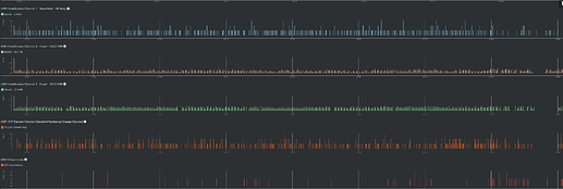

Based on what I found in your account, it looks like you’re experiencing multiple BLE and ANT+ disconnections, likely due to interference:
Try turning off any unused devices and check out this article for troubleshooting steps. You might also find helpful tips in this thread.

The only that changed is the update, i’ve been using it like this for months
I shows up instant like always but drops out all the time
There are ANT+ channels only at the picture from Jose - afaik you must use BLE for virtual shifting? Or is it different for Tacx?
I use BLE like I always have been, nothing has changed on my setup apart from the firmware update
