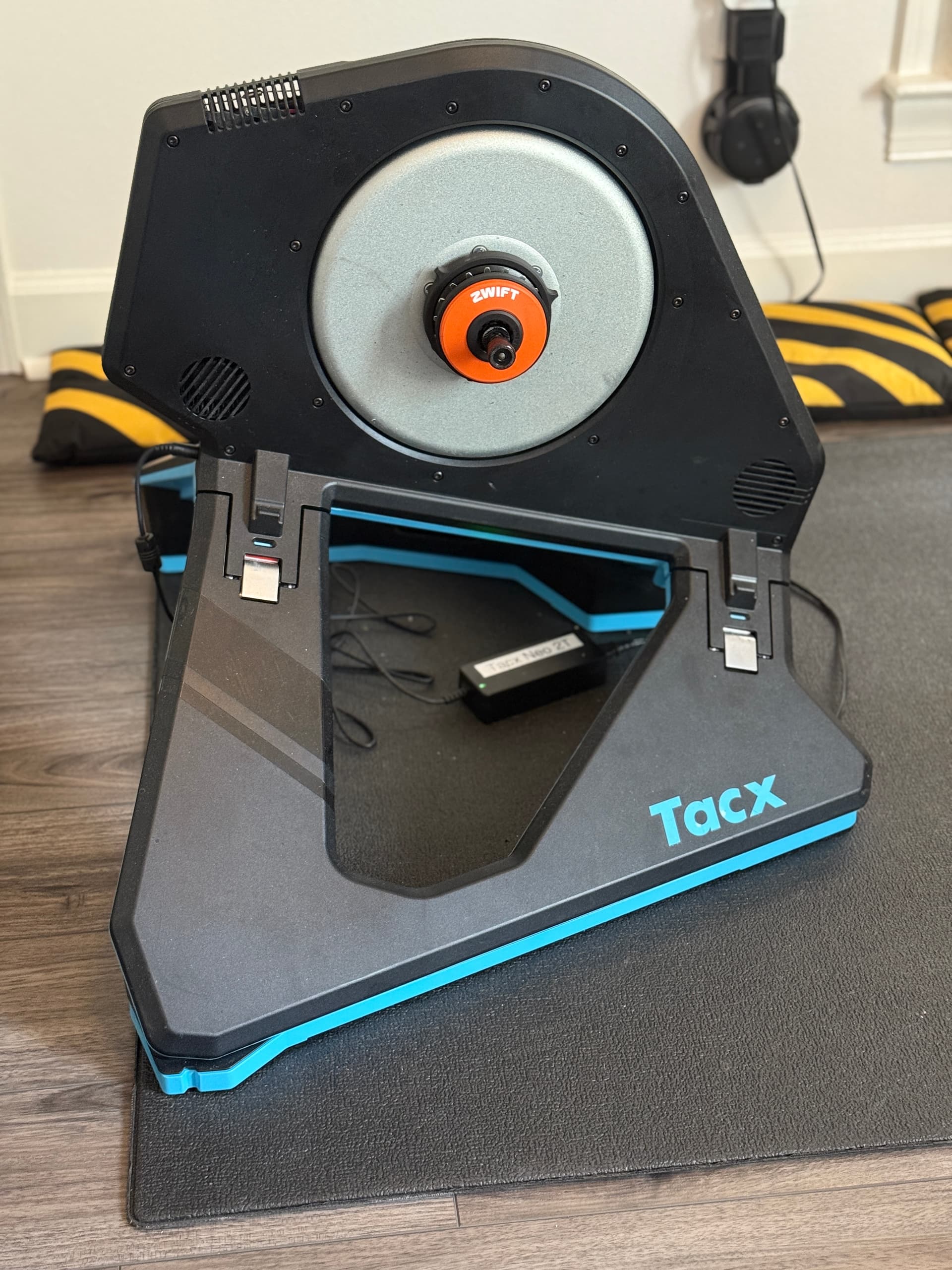

Hi Zwift Community,
I’m having trouble with my Tacx trainer staying connected to Zwift over Bluetooth on my computer after a recent firmware update, and I’d appreciate any advice. Interestingly, the trainer connects reliably to Zwift on my iPad with no dropouts, and virtual shifting works perfectly there.
Setup:
  • Trainer: Tacx NEO 2T
  • Firmware: Updated to the latest version via Tacx Utility app (post-June 2025 update for virtual shifting) 2.6.0
  • Zwift Device: Windows 11 PC
  • Other Devices: Zwift Click/Play (for virtual shifting), paired via Bluetooth
  • Zwift App: 1.91.0, build 147909
  • Connection: Bluetooth for trainer (Controllable and Cadence), power meter (Power Source), and controller (Controls)
Issue: Since updating my Tacx trainer’s firmware to enable virtual shifting, it won’t stay connected to Zwift on my computer via Bluetooth. It either fails to pair, drops during a ride, or doesn’t appear in the pairing menu. However, it connects perfectly to my iPad running Zwift, with stable Bluetooth and functional virtual shifting. The trainer also connects fine to the Tacx Utility app, so the hardware seems okay. Also, my power meter, heart rate monitor and Zwift play connect to my Windows 11 PC without issue.
What I’ve Tried:
  • Power-cycled the trainer (unplugged for 30 seconds, pedaled to wake).
  • Disconnected the trainer from all other apps/devices (e.g., Tacx Utility, Garmin Connect).
  • Verified virtual shifting is enabled in Zwift’s Settings and works on iPad.
  • Ensured Zwift app is updated to the latest version.
Question: Is this a known issue with the Neo 2T after the firmware update? Any ideas what I can do to fix this?
Thanks in advance for your help!

This sounds similar but my issue is over bluetooth. Also, my Play and heart rate monitor still work, connect fine and don’t drop.
I suspect a BT dongle on an extension cable may help you as well but I don’t have a Neo so that is a guess

My issues is also over BLE, I contacted garmin and I’m waiting for a reply
I’m looking for BLE dongle to try
I still honestly think it is a garmin problem because it just to much of a coincidence but not on every device, my Windows 11 pc doesn’t work but my Windows 11 laptop does work
Do you have 10Hz race mode enabled? If so, you just increased the amount of BLE traffic by a lot, so if BLE performance was marginal before and just worked, that might push you into failure. Having a dongle and USB extension cable to try would be a good troubleshooting step.
I’ve tried with and without the 10Hz and it makes no difference, i’ve ordered a dongle
I’ll reply in my post if it worked or not
