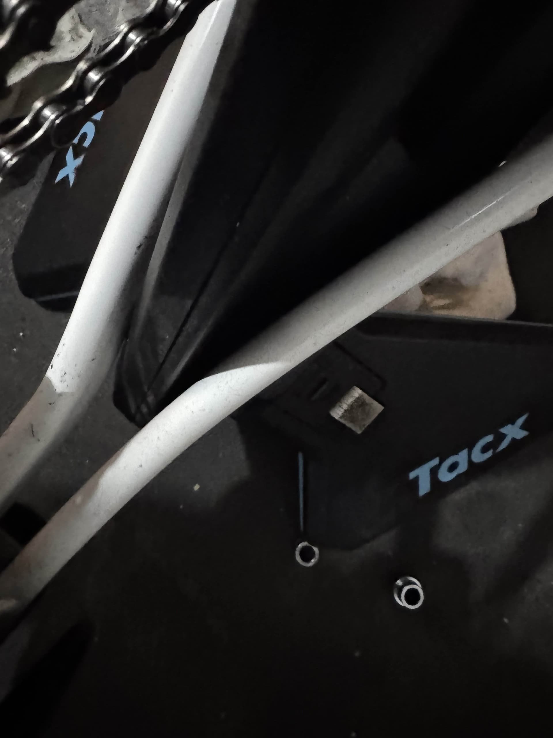

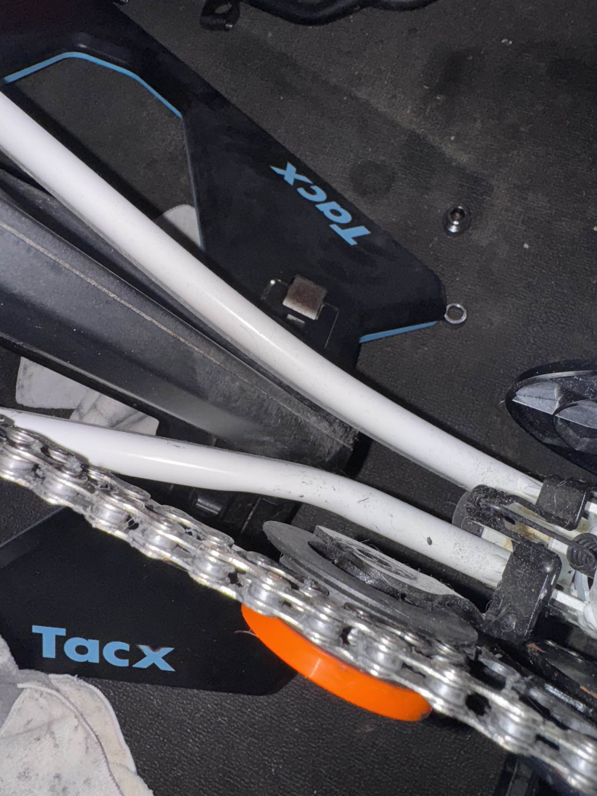

Well it fits but they are touching. Not honestly sure what damage to the trainer/chainstays would happen especially as the neo rocks probably not something i would want to test long term unless both were well out of warranty

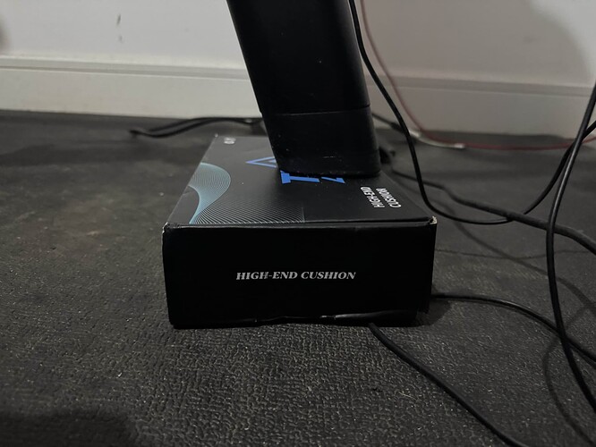

What happens if you stick something under the front of the Ride frame? I wonder if any of the front riser options would help.
i’d say you need an inch possibly two to give it clearance. wonder if those tennis ball feet would be enough
If you are getting a zwift ride frame the core 2 is only another £250 on top i’d just go with that. it’s new a solid trainer unless you do elite racing you are all good.
