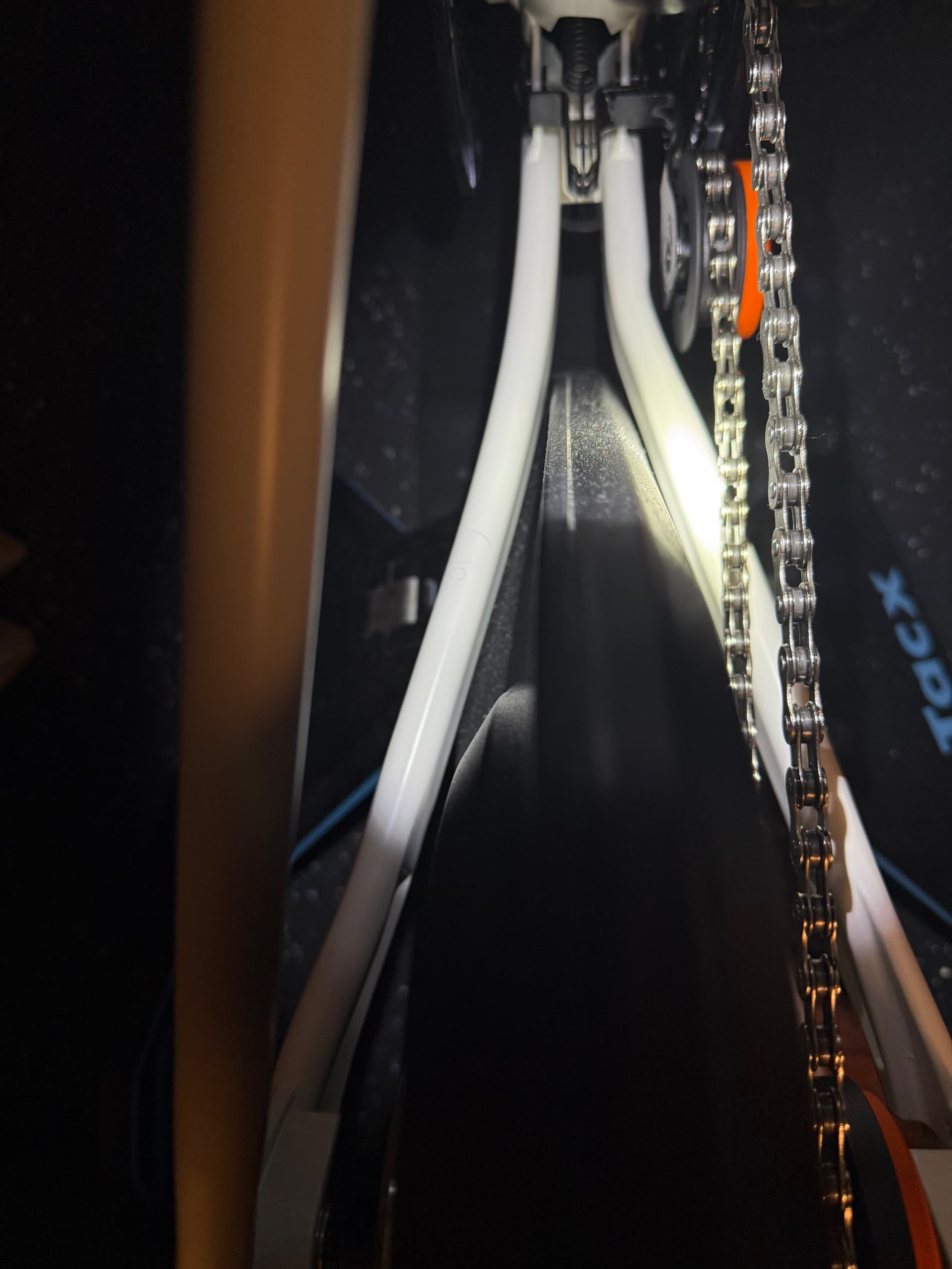

The NEO 2T barely fit and you need the large foot riser on the front. In my case I also have motion plates on my NEO 2T so I had to build a skateboard for the front with the right height to clear the Ride chainstay and keep the fore-aft movement.
Oh, very clever. Do you have any details of this?
I would like to Summarise the Zwift Ride Compatibility issue with the Tacx Neo 2 Smart, the 2SE and the 3M. Firstly thank you to Gordon qnd you all for helping me on this, as it was not well explained WHY by Garmin or Zwift.
The Zwift Ride rear chainstay has the tube inset on the right side to accomodate the tension adjuster, insteading of putting the tensioner back where a derailleur would go.
This means that the inside front of the chainstays is very narrow, and can only take narrow (such as the 2T) or ride systems that are more to the rear. So the Tacx Neo 2 Smart (and 2SE and 3M) may squeeze in between the chainstays but will rub at the front. The 2T is slightly narrower but there is almost no margin for sideways movement when standing during climbing,but the 2T is only just “compatible”.Hmmm. Please see Gordons photos higher up on the comments and it becomes easy to understand. I love my Tacx (great road feel and realism inc downhill) but I cannot go with the Zwift Ride (which I also like)

I would be careful as the narrower 2T only just fits and as you see from the photos abovefrom Gordon, yes you need to rise the front. But there may still be contact,… particularly as the Smart does have side to side movement. Yes you can buy the adapter from a web shop if necessary. I have decided to adapt my oldest road bike with the new Zwift Cog2 and Click update kit,…but I may need an adapter too…..will see when delivered.

Jon is correct about having to raise the front of the Neo trainer that can fit the Cog. I slotted in the Tacx Riser though it isn’t flat but got the job done for me. I tried asking my wife for the wooden chopping block for the kitchen and got a growl… so that’s my story.
