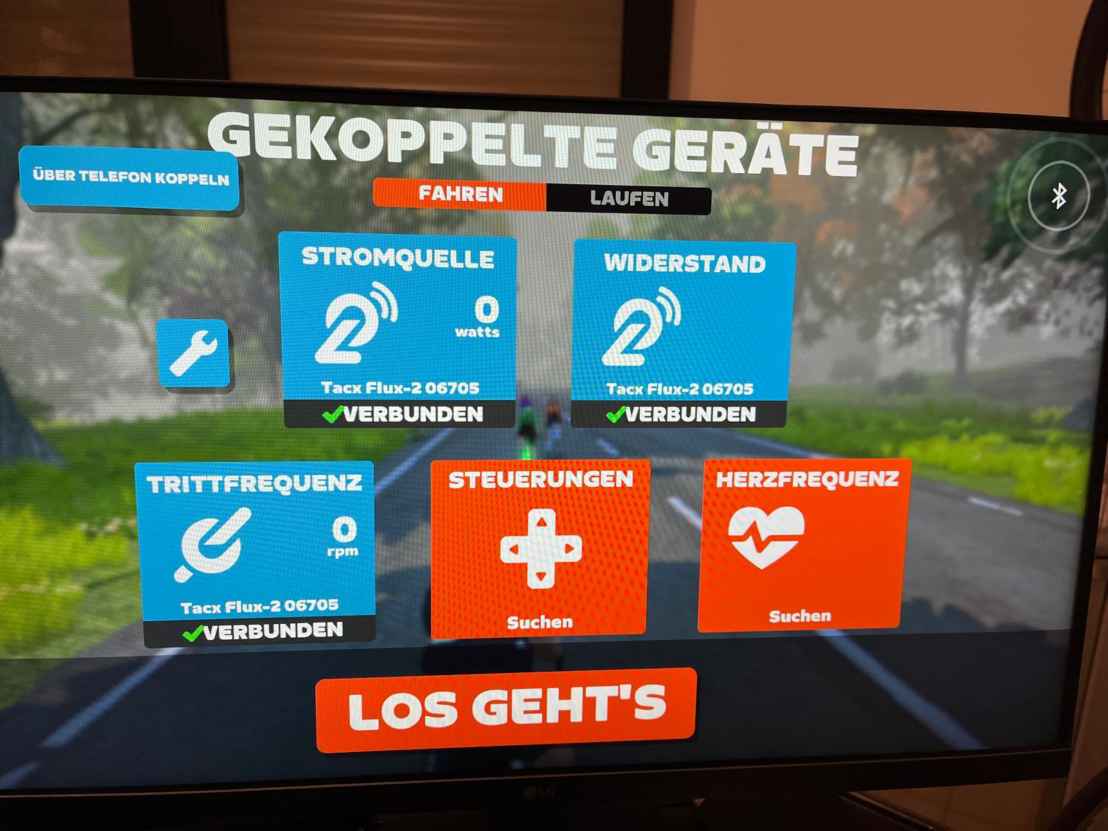

@Peter_Tanimgej @Morten_Siemoneit could you please share a screenshot of what your Pairing Screen looks like after you’ve paired your trainer as Power Source, Resistance, and Cadence?
This is the screen paired without Companion App.
If i’ve paired with the App the litle Wrench is missing
