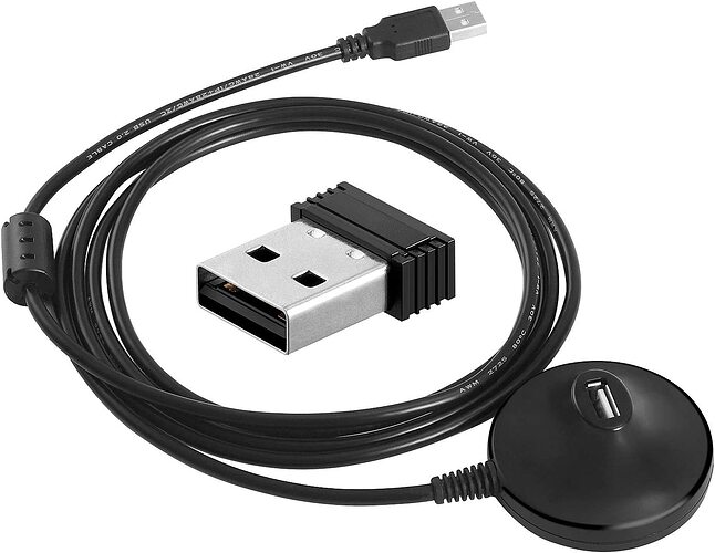

Hi, make sure it isn’t paired to the PC, then open Zwift, you shouldn’t need the companion app at this point. However, ANT+ is much more reliable so I would also suggest you go that route. Amazon has quite a few options, there is a bundle with the extension cord that works well.
yeah - if it is paired to your PC in the settings you’ll need to forget it from there and then load zwift and it should be available for selection.
I just use the dongle that came with my trainer - have a look on amazon there should be quite a few on there. Not sure if any other users have recommendations?
not got it myself so can’t comment on it’s quality but something like this looks good and comes with an extension to get it as near to your trainers as possible.
