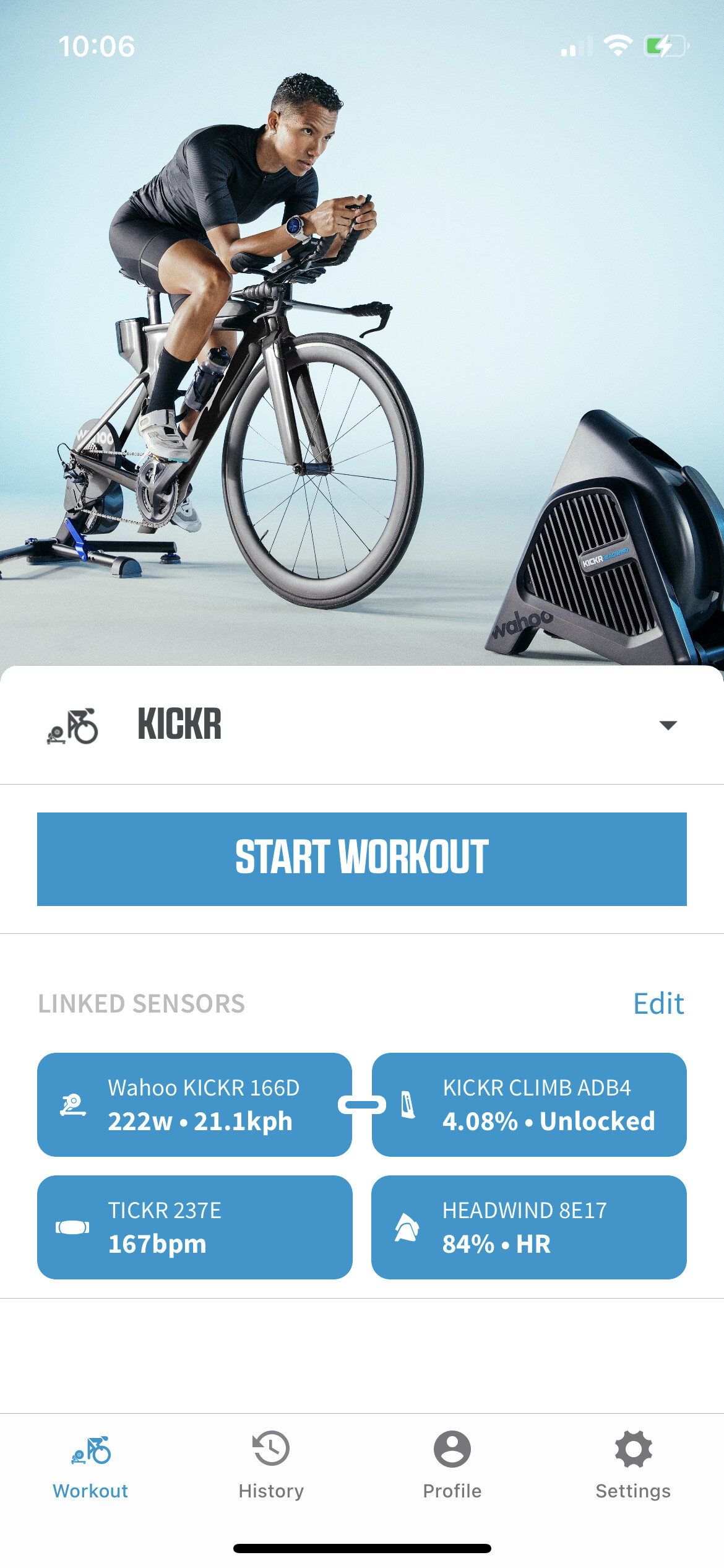

I use ATV 4K (2017) and the update also broke my KICKR5 and climb. The climb and resistance do change, but not in sync with whatâs on the screen. For example, on out and back again after volcano KOM and heading towards Italian Villas. 0% on screen, but 5% sent to KICKR. TD is at 50%, so the game is sending a 10% gradient when showing pan flat on screen.

Same issues again today with Apple TV 4K. This time on Makuri Islands. Trainer Difficulty still at 50%. On screen -5% gradient, but +4% sent to the KICKR.
I may be missing something, but how are you seeing both of these at the same time, considering your trainer canât connect to more than one device at the same time over Bluetooth? Is the device running the Wahoo app using ANT+?
Wahoo supports multiple Bluetooth Smart connections to the KICKR, enabling you to connect with up to 3 Bluetooth Smart devices to the KICKR at the same time. So connected to Zwift as normal, and opening the Wahoo app on iPhone shows what gradient is being sent to the KICKR and how much power is being produced. Been like that since the September 2019 KICKR firmware update
Thatâs good to know, thanks, and a handy feature to have.
