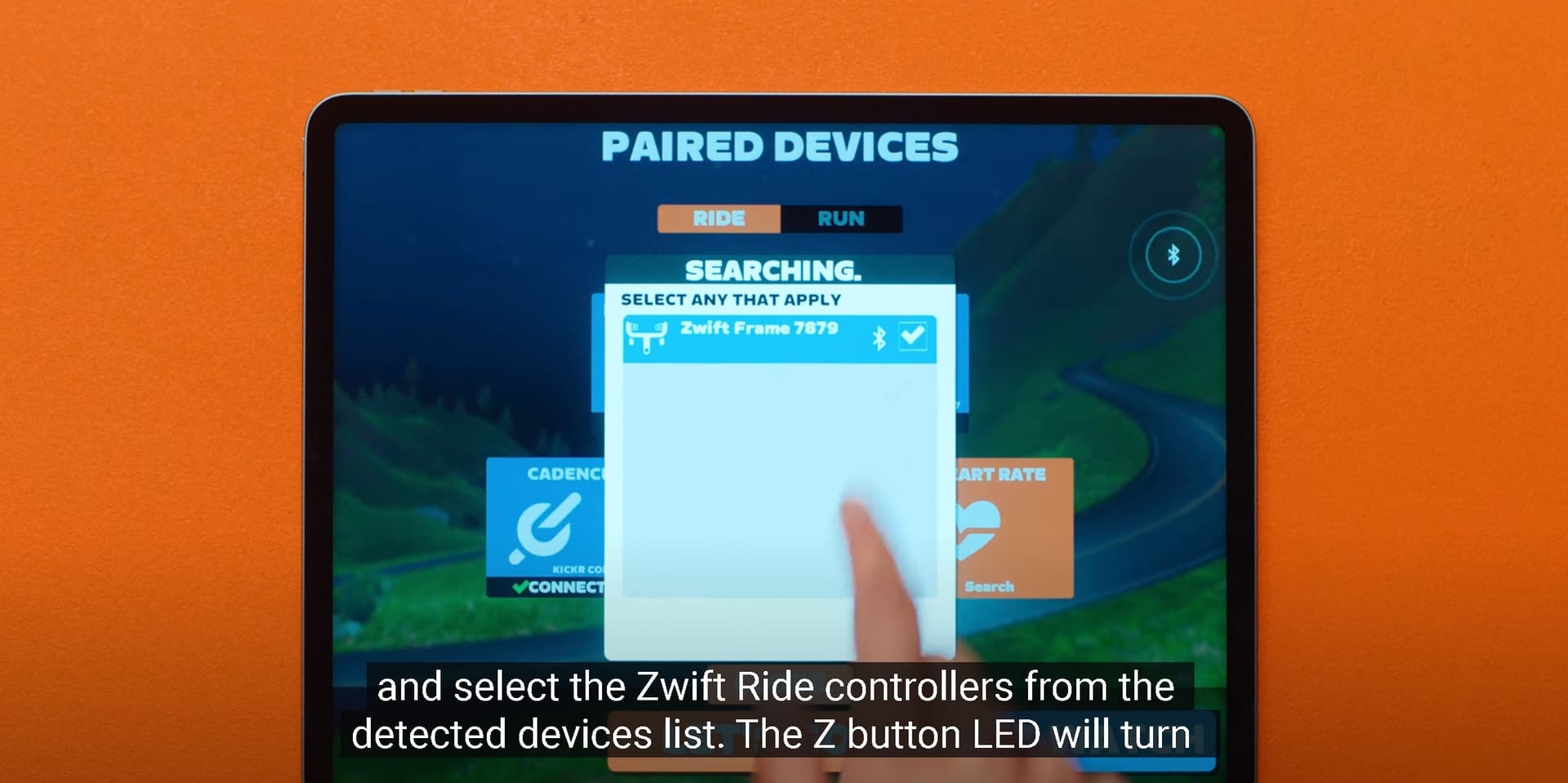

I bought the new Zwift Ride (Frame+Wahoo Kickr core), but when pairing the controllers in the Zwift game, I cannot tick the little box. See the photo of my Zwift game on PC (I have the newest softeware: v1.69 on windows).

But whatever I do, I still cannot tick the box as you can see in this photo:
One thing that did catch my attention: on my photo I see that my PC has found a “Zwift Ride 9ABA”. Technically this is the name of one of the two controllers. As you can see in the screenshot of the official video by Zwift, they show that the game should find a “Zwift Frame 7879”…

@Den83_Hoogeboom_CS01 on the top screenshot, it looks like your trainer may be paired using ANT+ rather than BLE. Since virtual shifting only works over BLE and we only allow you to pair a Ride if you’re connected to a trainer and in a way that supports virtual shifting. Cab you confirm if you’re using BLE or ANT+ to connect to your trainer?

Shuji at Zwift HQ here. I’m looking at your server logs and what @nate-zwift says is correct - your Wahoo is pairing to the game via ANT, and that’s not going to work. Virtual Shifting requires that your trainer signals and the controllers are all paired over Bluetooth. Unless you have a heart rate monitor that pairs over ANT only - you can simplify your life by unplugging the ANT dongle from your PC.
Not sure where you read this advice, but this is incorrect. You should not pair the trainer or the controllers to the OS of your computer as you would Bluetooth earbuds. If you do - the Bluetooth signal will already be bonded and won’t be available to the Zwift app.
Please try those two things, and let us know if that clears it up? TIA.
That solved it! Wauw, I didn’t realize it was that simple
Up to a week ago I owned a Tacx Neo 1 (2016) and all those years I had that connected through a dedicated ANT+ dongle, which worked like a charm. This dongle was still attached to my PC when I installed the Frame and Kickr Core. When I booted up the Kickr Core for the first time a few days ago, it automatically paired through ANT+, so I assumed that that was the best way of pairing and never realised/bothered to re-asses that assumption…
