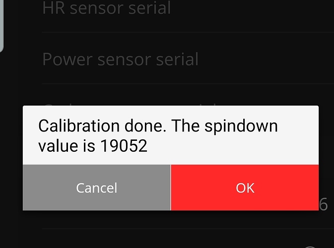

So I thought I’d do a spin down calibration on my trainer using the elite app, as I can’t see where to do it in Zwift?
I did the spin down calibration and got a result, saying success.
Go back to Zwift and the resistance is huge for the given wattage on the screen. I really can’t figure out what is happening.

I had this same problem tonight. Zumo was working fine until I did the spindown calibration. I got similar spin down values to you. I checked the power in the elite training app and those values no longer look realistic. I think I must now have a very poor calibration but I’m not sure how to put it right. If you have any success, please let me know!
Was your spin down time long? My spin down seemed to be with no load from the trainer so takes 30seconds plus.
Very frustrating, wish I had stuck with the factory calibration!
The spin down seemed to be unloaded like you say, then power was all over the place.
I did a test that Elite suggested,start a 1 in level mode and ramp it up to 16, resistance was fine, power was totally wrong.

I took some more screenshots of the power measurements today which I will send to elite tech support. Curiously the power measurements on resistance level 1 look fairly sensible but then as I go up the levels the power drops off whereas it should build.

Had a response from elite today after sending them the trainer map. They told me the trainer is working fine but the spindown did the calibration in reverse hence the reduction in power measurement with the increase in level. They have advised me to take it back for a replacement.
