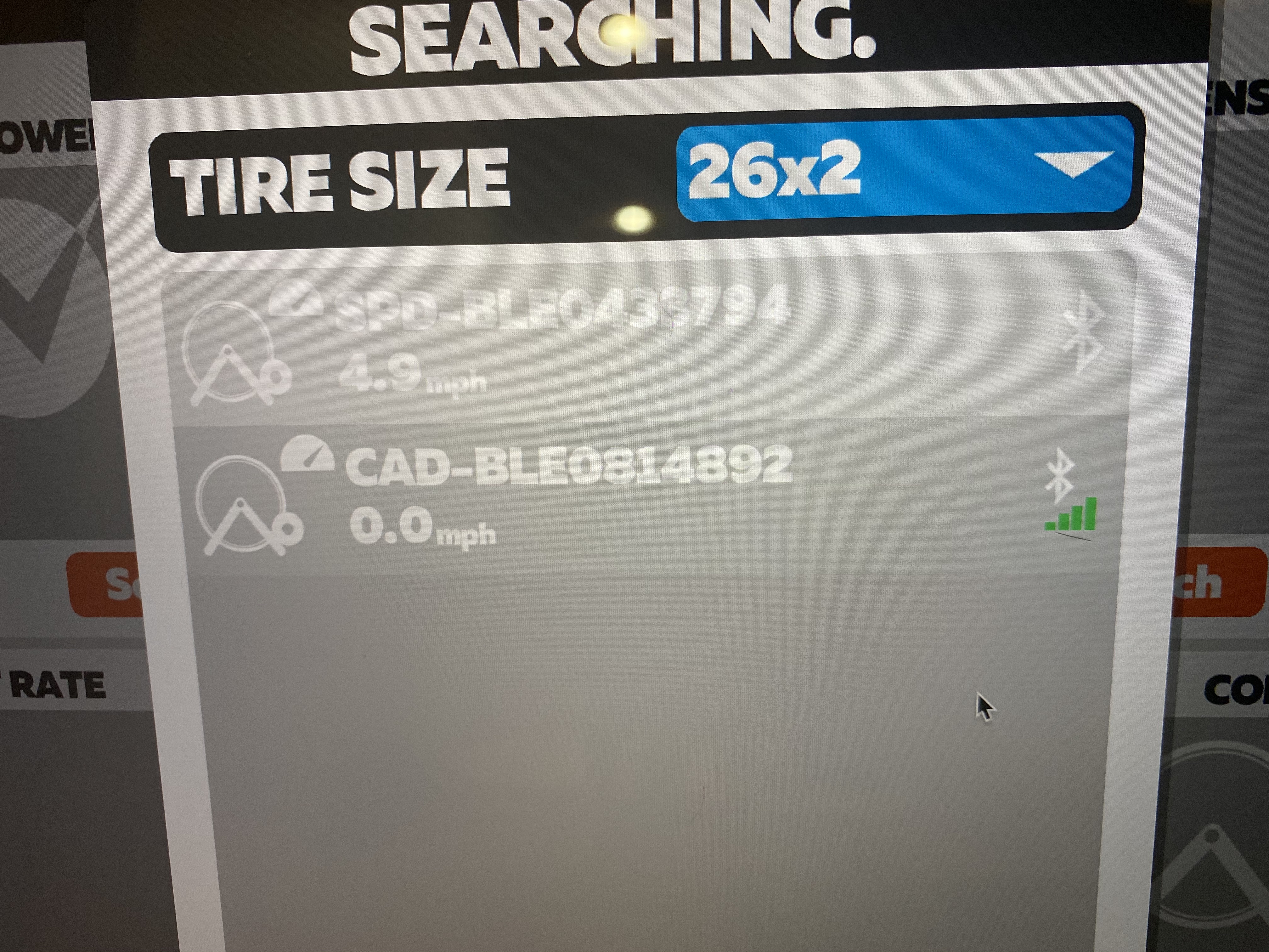

What does your pairing screen look like on zwift? Can you attach a photo, maybe someone can see something obvious.

I am able to connect it to my garmin connect app (see attached pic). I am attaching the other pics I took of my laptop showing how it is paired.
Hmm these pictures suggest you have connected to the trainer itself rather than your new garmin speed sensor. Unpair from the garmin app (from memory a Bluetooth sensor can only be connected to one thing at a time) and try to select the speed sensor from the menu (the pairing screen picture says you are connected to the kenetic).

Also in the pictures you seem to have 1 or 2 mph not 0 for some reason.
Will try your suggestion and unpair from the IOS garmin app and see what happens. The Kinetic is only a dumb trainer with the speed and cadence sensors. Unfortunately, I do not have a Garmin head unit to test that out. Yes I did notice that too about the speed. Before it was only showing 0 mph. When I was taking the pics, it showed a speed of 1 -2 mph but the avatar would not move. The cadence sensor showed about 85 - 90 RPMs at the time.
