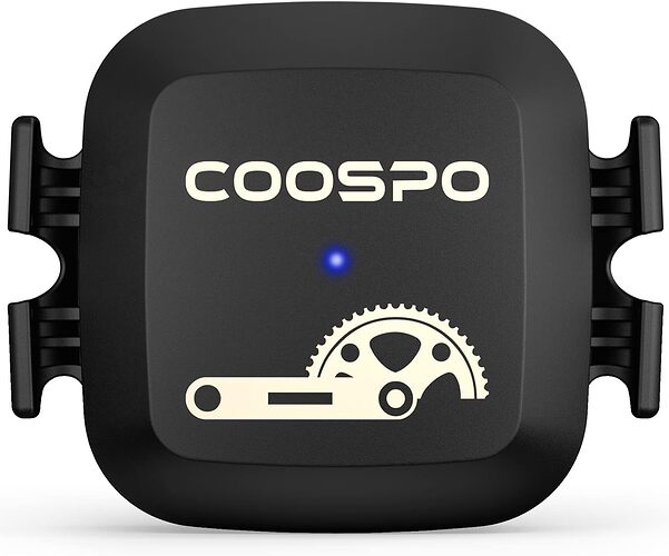

I’m assuming your trainer is a Wahoo Kickr Core. Most smart trainers like that do not measure crank arm revolutions. They are guessing at your cadence based on the tension on the chain. They often do a pretty good job but not always, especially when the Watts are low. A cadence sensor that actually measures crank arm revolutions will give you an accurate measurement. You could contact Wahoo support about it, but given how cheap cadence sensors are, I think the smarter move is installing one of those on the crank arm. There are many options out there, this is just an example:
I see thank you for the advice. I will try this out. Yes it is a Kickr Core but what is weird, my old setup which had a Kickr v5 never had this issue

Update: I installed a Garmin cadence sensor on the crank and now I have reliable RPMS – zero spikes. But this has not changed the issue with the spiking resistance.
