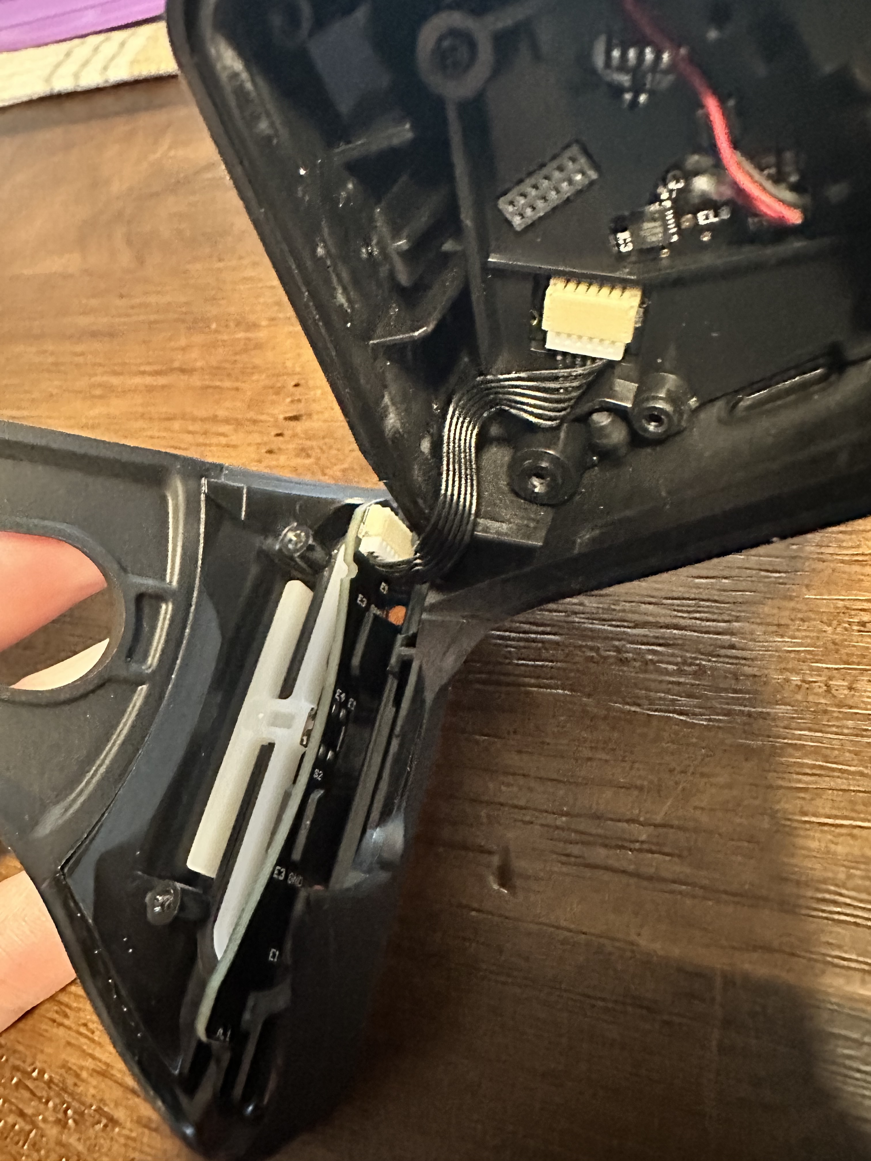

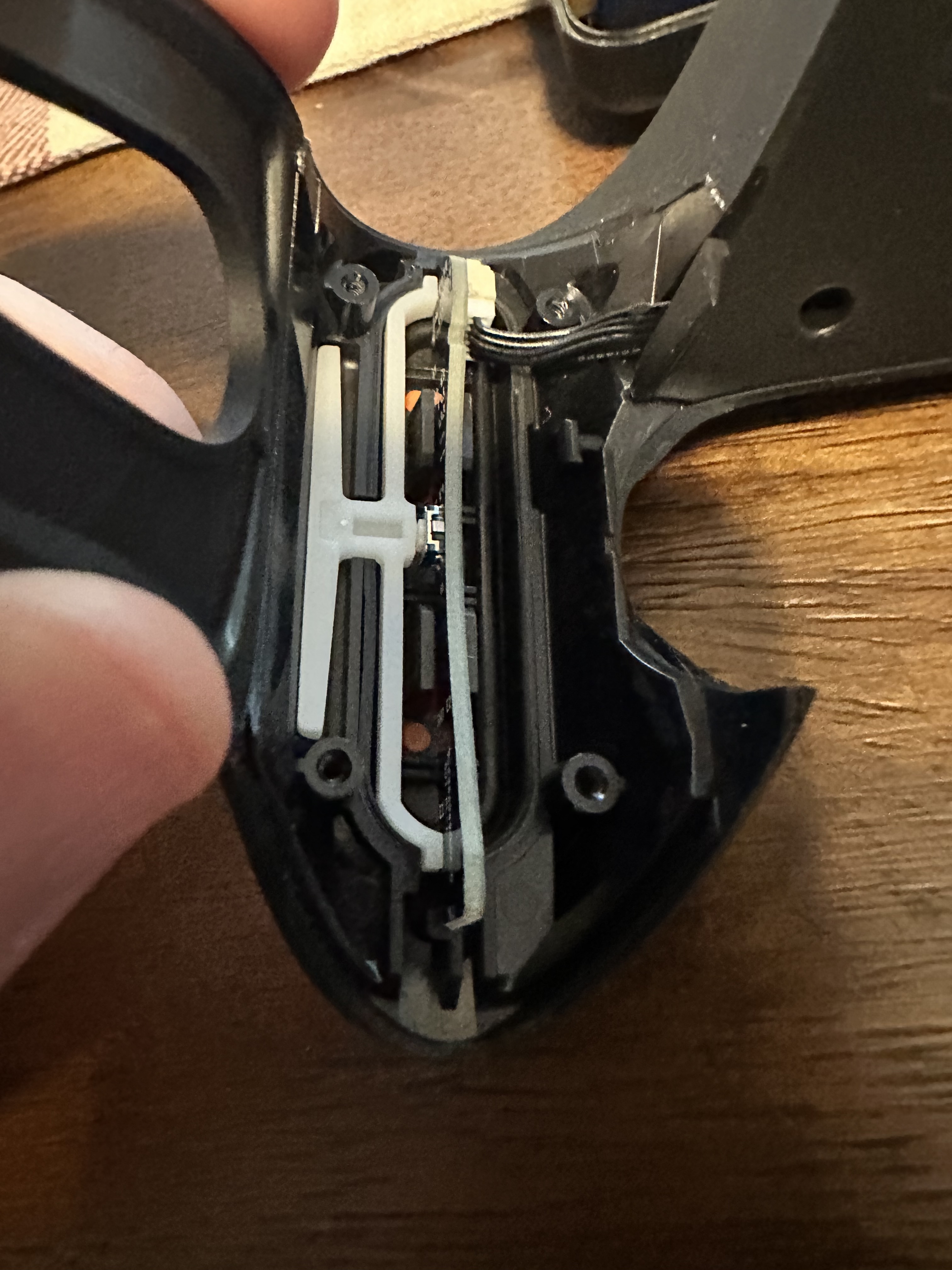

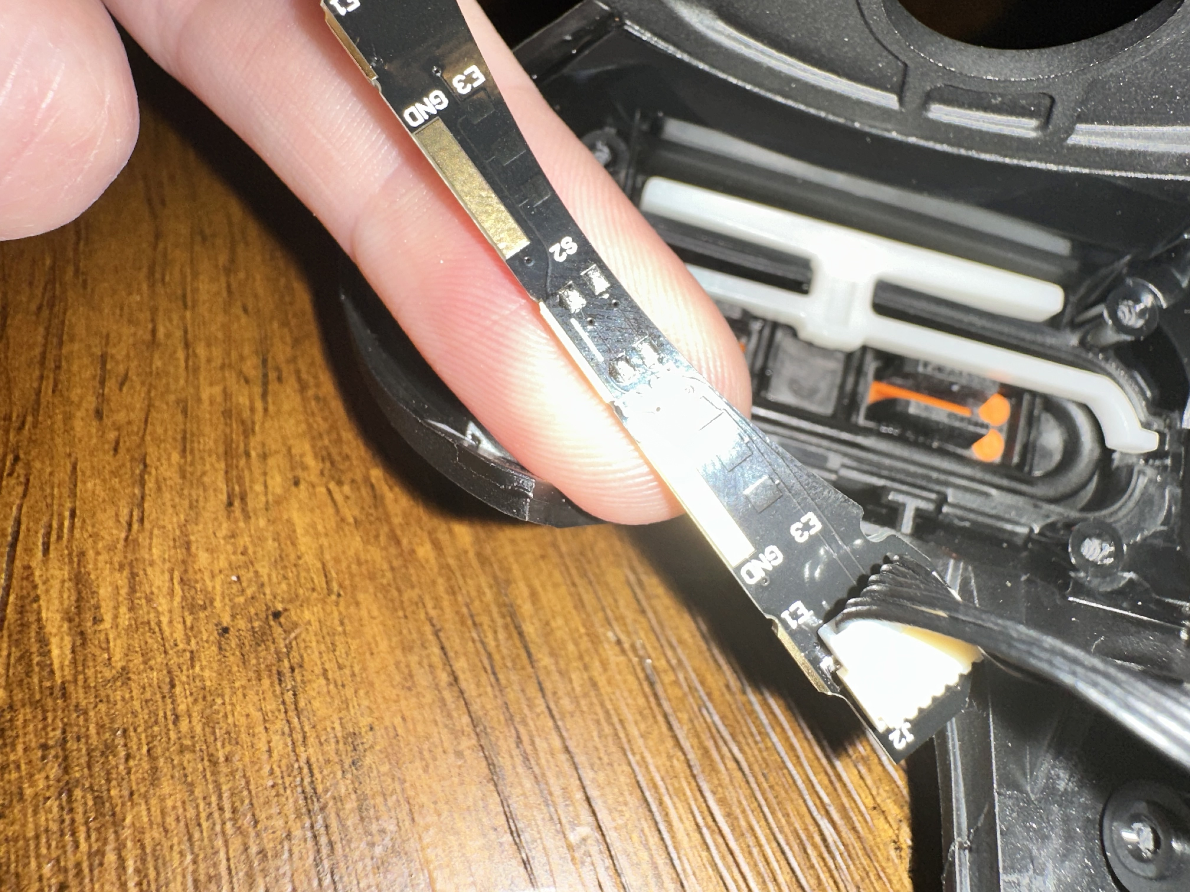

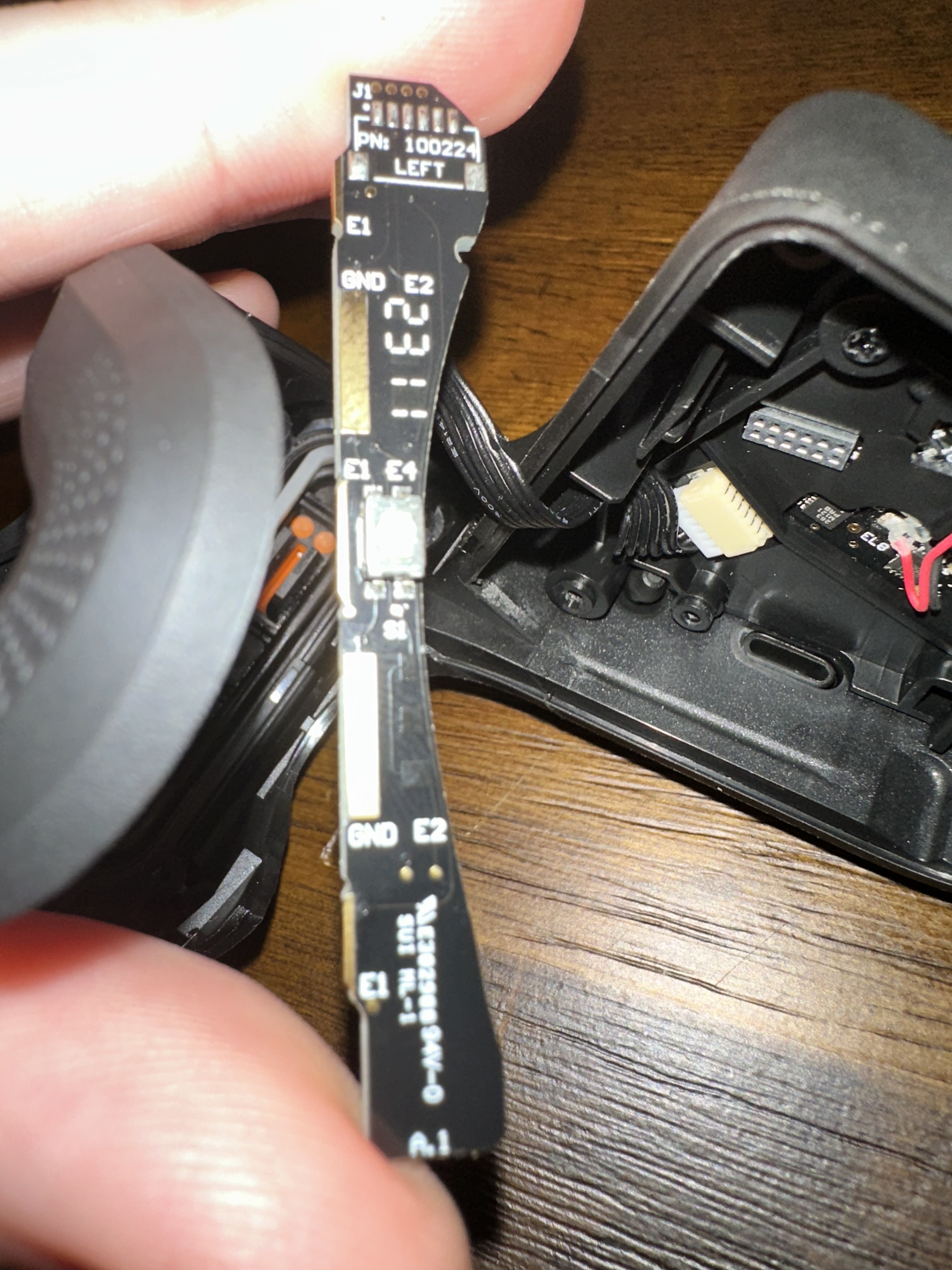

Sorry to revive this topic, had the same issue with brakes being applied. Opened up the left controller, don’t really see a whole lot of corrosion or sweat ingress, and not a crazy sweater and have lots of airflow during rides. All I’d like to do is disable braking entirely at the hardware end, and I think if you can cut one of the connection wires that sends braking signal it may allow you to use the rest of the functionality of the play controller.
Not an electrical engineer obviously, anyone out there able to help identify which of the 6 signal wires I would cut? I’d be ok even if steering went away…

Not sure if it works but worth a try: Cover the connector side of the circuit board with adhesive tape to avoid the electric contact. You can try with a piece of paper first before reassembling.
Edit: Just gave it a try with my spare unit, it doesn’t work, sorry.
