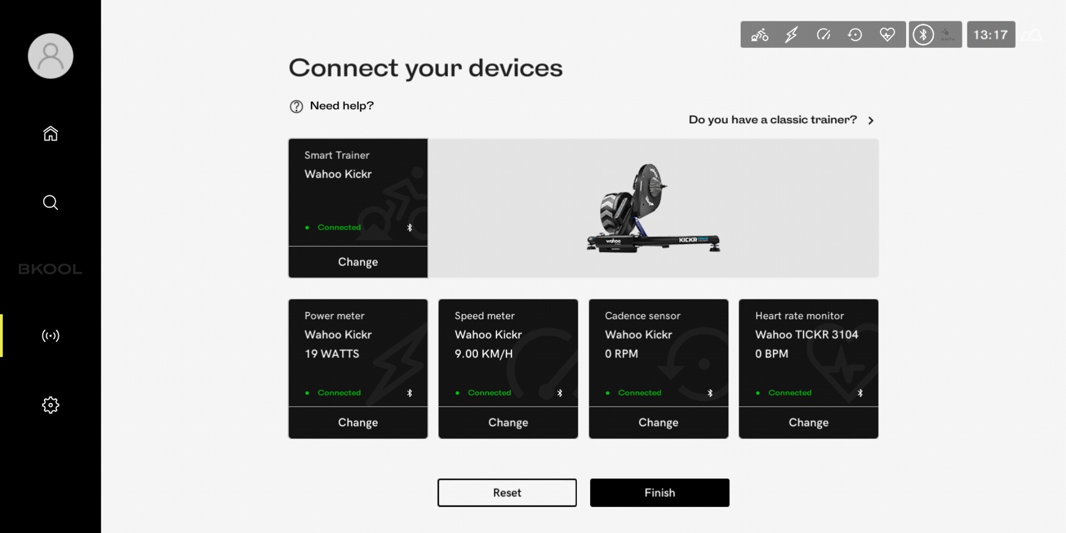

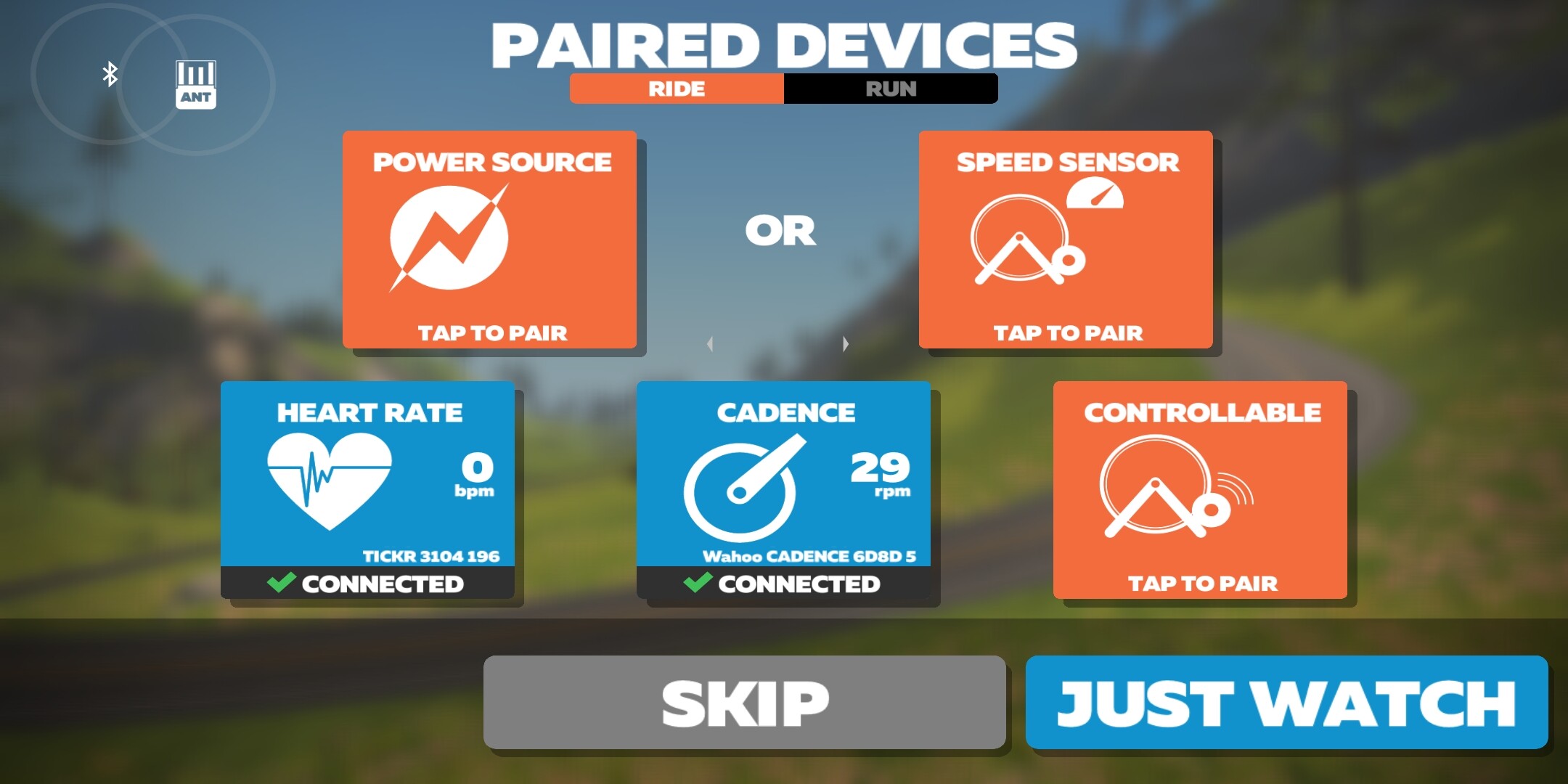

I don’t get Zwift (Android App) connected to my kickr 4.0 as Power source. Separate HR-monitor and cadence sensor will be found in the App via BT. First I thought the Kickrs BT module could be broken, but in Wahoos Fitness app I get connected. same in BKOOL app. Kickr, speed sensor, cadence sensor (all integrated in kickr) will be found.

I usually have to connect the trainer as a power source first then it appears in the controllable section. If i try and connect it as controllable without it paired as anything else it doesn’t appear in the selection.
In my case, the Kickr doesn’t show up as Power source at all.
Even if I wait a couple of minutes, it doesn’t show up.
On the other hand in BKOOL

The cadence sensor is a separate one, not the integrated one from the Kickr. Even if its not connected, the Kickr won`t be found

As I mentioned before, I deinstalled all other apps e.g. Wahoos Fitness app, BKOOL, even ZWIFT. On all apps, I cleared cache and downloaded data before deinstalling.
A freshly installed ZWIFT can still only connect to HR-Monitor and a separate cadense sensor over BT
