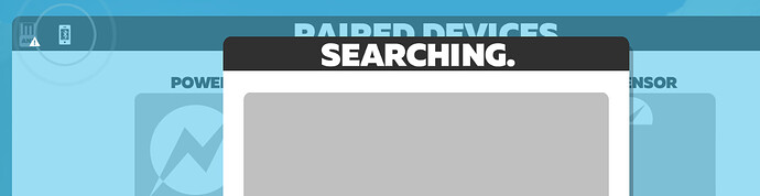

I tried going through the companion app setup. There are rings in the top left corner, which shows that the phone is attached to the computer. In fact, the app changes to the controller mode. However, when I click on pair device on the computer for any of the devices (ant+ heart and cadence, wahoo kicker core) nothing happens. It just says SEARCHING, without ever finding anything. Any ideas how to fix this?

As an update, I turned everything off, and turned it back on (both computer and android app). The Kickr was found!
However, the ant+ heart rate and cadence sensor were not found. My phone can use ant+. Is the ant+ on the PC supposed to connect through the phone?
Ivan
Glad the Kickr was found!
Zwift Companion only works with connecting Bluetooth devices. For ANT +, you’ll need to connect an ANT + dongle to your computer so your devices can read it.
