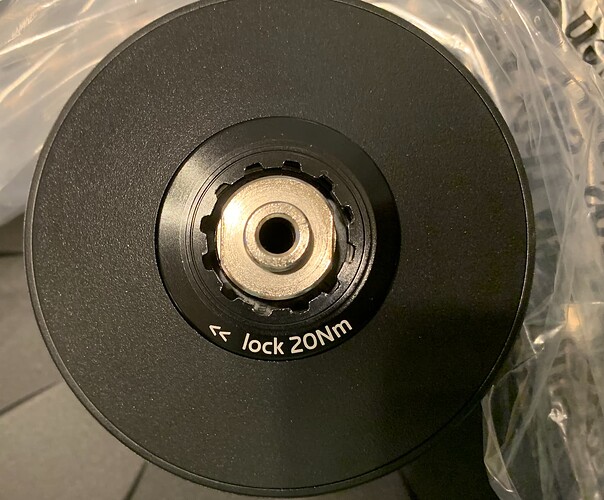

I contacted support about the quick release being impossible to remove and they sent me a new trainer after multiple follow-ups. The support team is NOT good but eventually I received my new trainer. The new unit has the torque spec written on it and the pre-installed quick release adapter came off with very little effort. Seems like they had a bad batch, knew about it, shipped anyway, and planned on exchanging problematic ones as the new one came in two weeks after receiving my first.
Wonder if the torque spec is for me, or for the assembly factory who over torqued it in the past!
No I suspect it is for anyone who is used to a torque of 40NM for the lockring on most standard cassettes. Possibly a few have already been stripped and returned?
I believe the torque for the quick release adaptor remains at just 6NM
is that not the spec for the lock ring that it is written on though?
Yeah that 20 is not for the adapter. It’s interesting the lock ring is at 20, but I guess it’s a couple of plastic bowls and not a cassette that will be shifted through.
