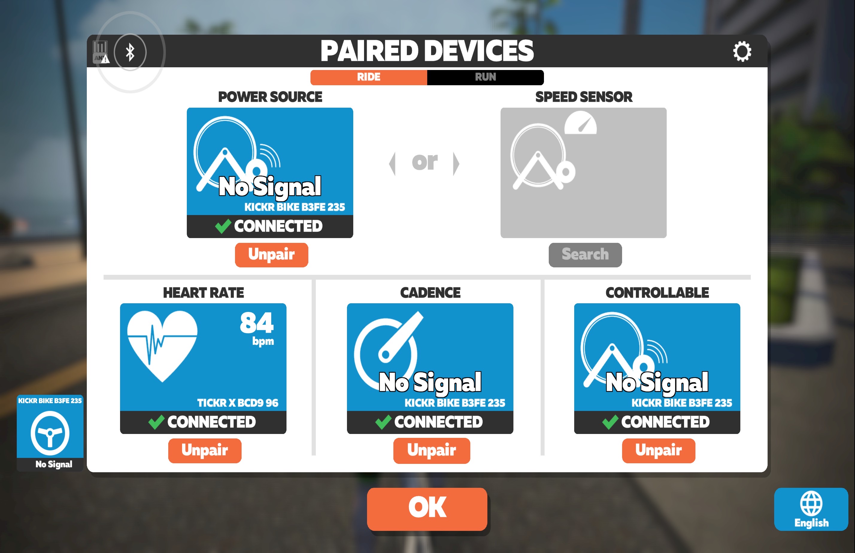

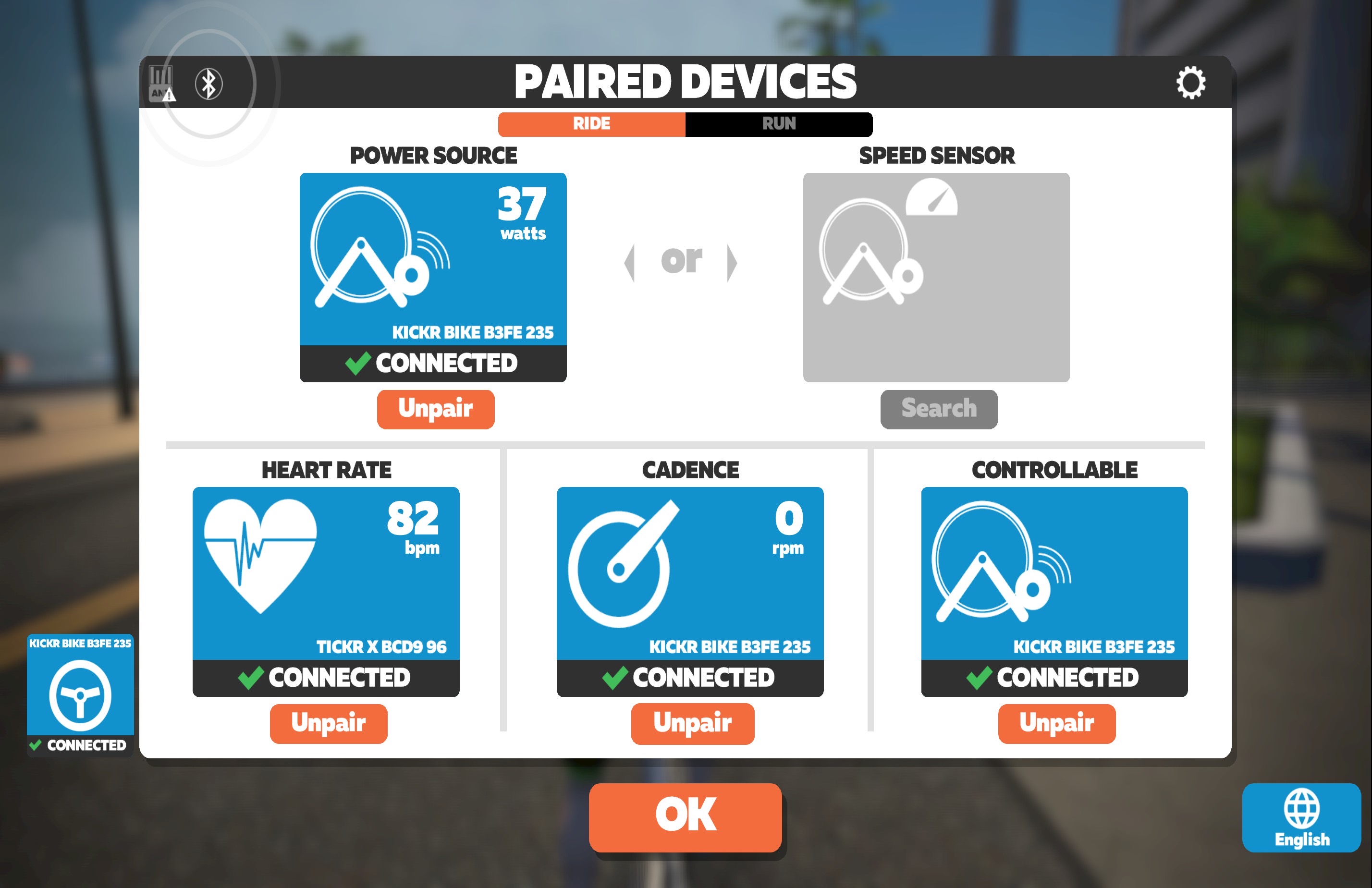

Interesting you are having issue with Tickr but not Kickr Bike. I am having the exact opposite with brand new Microsoft Surface Pro 8 and Windows 11, Kickr Bike but no issues with Tickr X. No issues with previous Surface Pro 5 and Windows 10 either.
When this occurs, I get Zwift pairing screen cycling between Kickr bike data and no signal. This all sounds rather similar but with Kickr Bike rather than Tickr having issues.
Everything works fine for a short distance, then mid ride connectivity just drops out.
Thankfully for time being using Zwift companion app as a bluetooth bridge seems to work ok.
