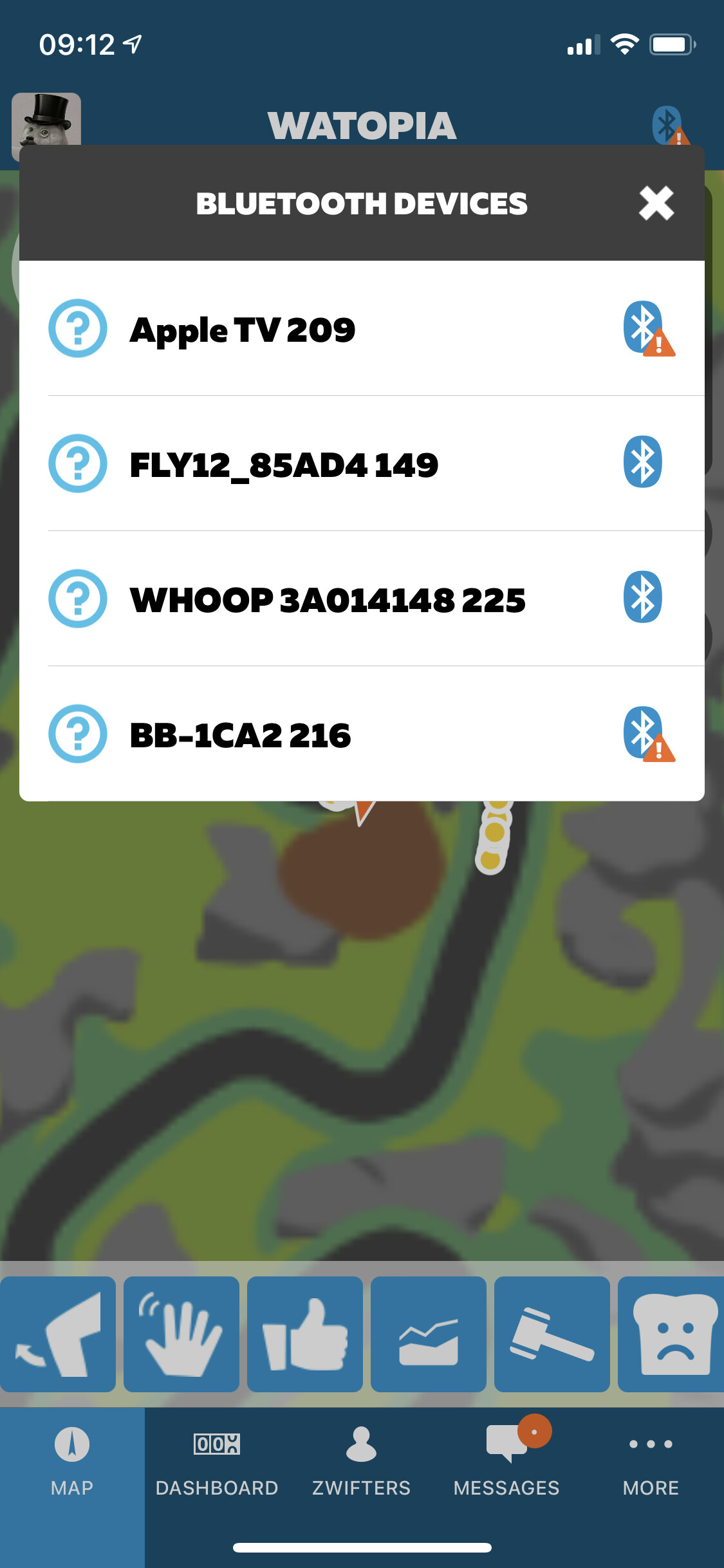

Oh so another random thing that was happening before was when I opened the companion app it kept trying to pair with my wifes Garmin watch. She had to turn it off so I didn’t keep receiving the pop ups.

Spent ages yesterday and today with my AppleTV, iPad and iPhone trying to work out was was going wrong. Like others here I had all sorts of random Bluetooth devices listed in the companion app and had my partner’s Garmin watch constantly trying to pair. Deleted and reinstalled everything. In the end I installed Zwift on my Mac and was able to pair everything directly to the Mac rather than through the companion app so I could ride.
