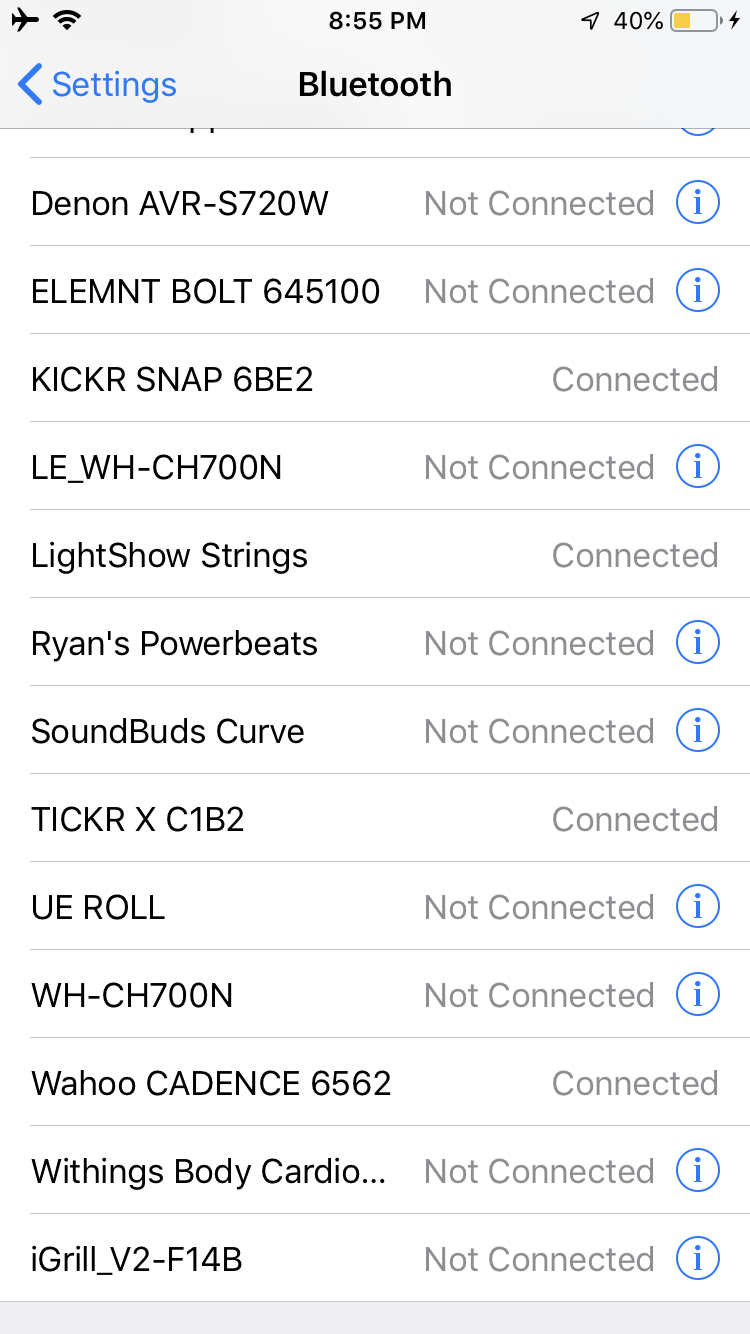

I was not able to disconnect the sensors in the device list. At first, when I couldn’t get the 3rd sensor to connect, my device list screen looked like this:
Note my TICKR X is connected but it does not have a “circled i” after it. I believe this tells me that something else is managing the connection with this device and it wasn’t the Zwift Companion. However, I could see the value of the TICKR X in my Wahoo Utility app. It would not allow me to tap on it and “Forget this Device” like the other devices with the “circled i”.
After I deleted the Wahoo Utility app and got the ZC to work, my device list looked like this:
You can see my trainer, cadence sensor and TICKR X all connected but presumably being managed by ZC, not my phone.
If anyone knows more about how “competing” apps choose to manage the connection of a particular Bluetooth device, I would love to hear more and I think this would help many with their ATV connectivity issues. Although frustrating, it’s nice to have a solution!
Again, thanks for all the help and Happy Zwifting!
