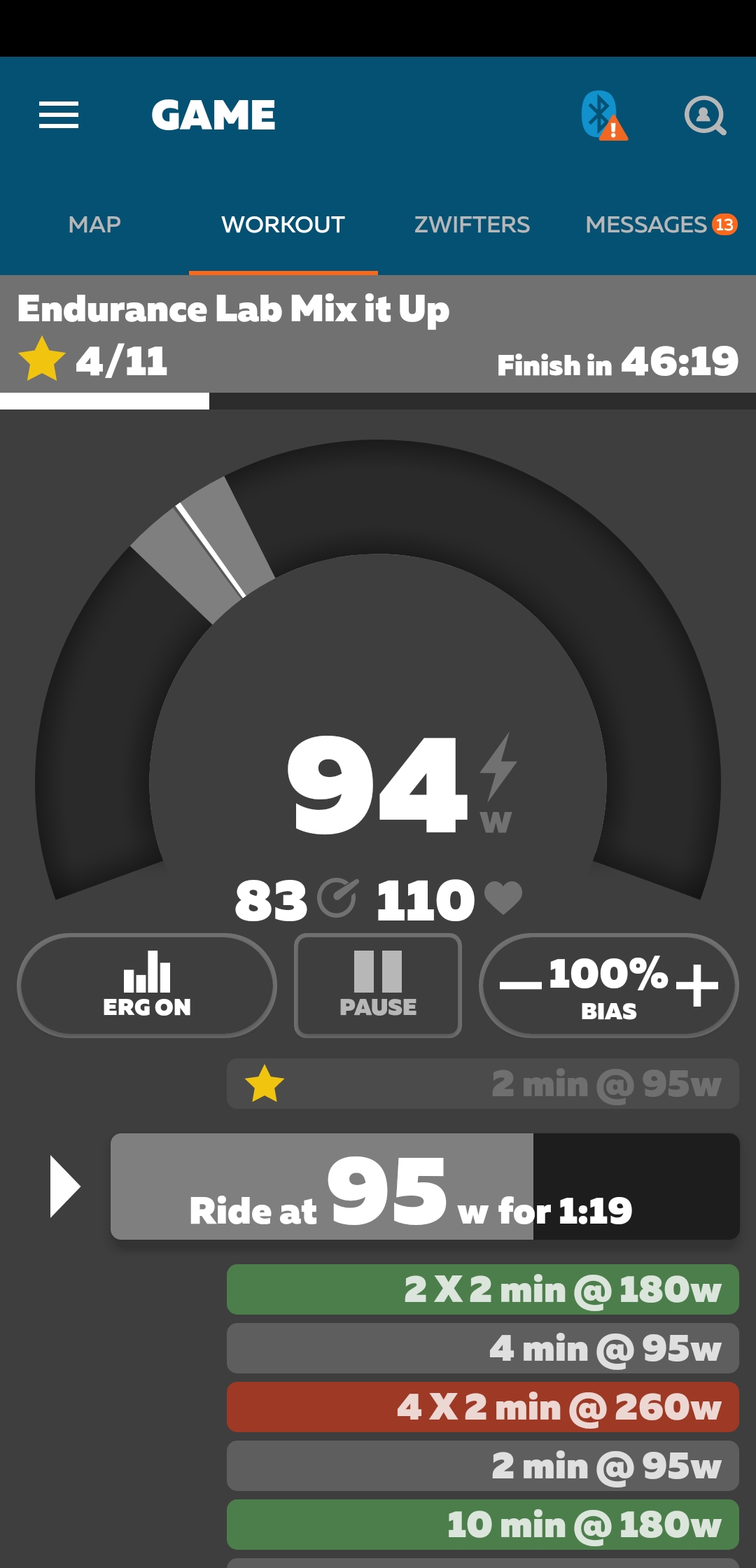

Hi,
I did as you suggested, I disconnected everything from my Bluetooth on my Phone. Only my headphones were connected via Bluetooth after everything else was connected. I was able to initially to connect to my Core, HRM and Cadence, the latter connected via the companion app.
I was doing a group workout, initially before going to the holding area everything was showing correctly. I went into event holding area, there was about 5 minutes where I was not with the bike.
When the event started, I noticed the cadence was not showing on ATV, the Companion App was showing cadence however. I noticed a ! showing next to the blue tooth icon on the Companion app, which I clicked and the ! was next to the cadence sensor.
Tonight, will try cabled headphones, but an android phone (Huawei p20 pro) should be able to run more than one Bluetooth signal.
I’ve attached a couple screen shots on the app. On apple TV the cadence was greyed out. Strava has not recorded any cadence reading for the whole workout.
