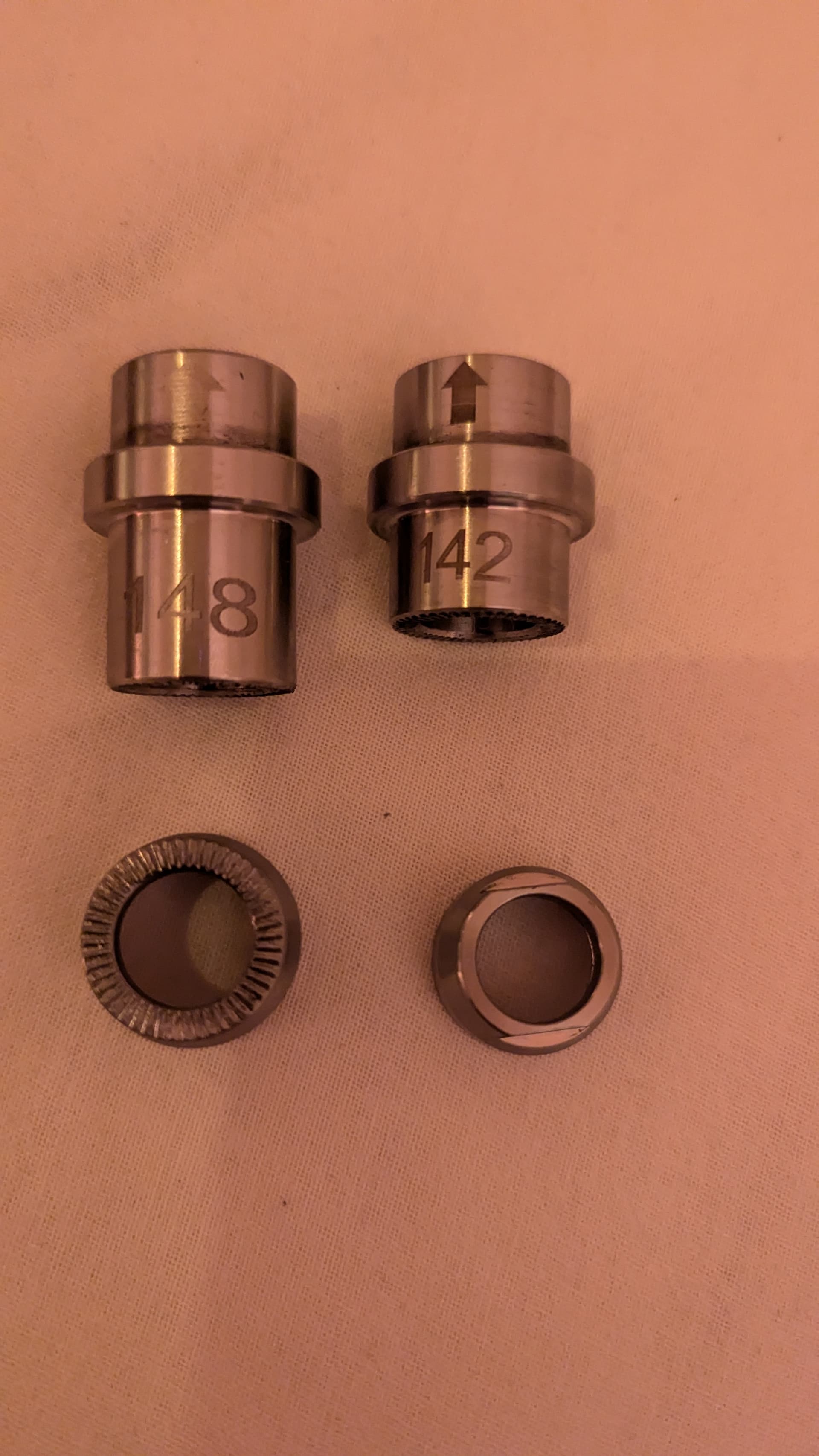

Back to the adapters, do you have the spacer labeled with #2 in the picture above?
Hey Jürgen,
I have these adapters at home
My zwift cog looks like this:
When I loosen the axle I can move the the cog freely in the freewheeling direction, and in the other direction it would turn on the kickr. Though, as soon as I tighten the axle, it stops. So I guess I would need to use one of the adapters. On the no-wheel side I used the 142mm adapter. Though on the other side I didn’t use an adapter. Funny thing though is, that it used to work without before and all of a sudden in the middle of my ride 6th ride or so, the loud clicking noise appeared and I couldn’t freewheel anymore.
Cheers
You need the 142 adapter on the non drive side (already installed as you said) and you need the left one in the second row. This adapter should slide over the nut on the drive side, the serrated side facing outwards.
