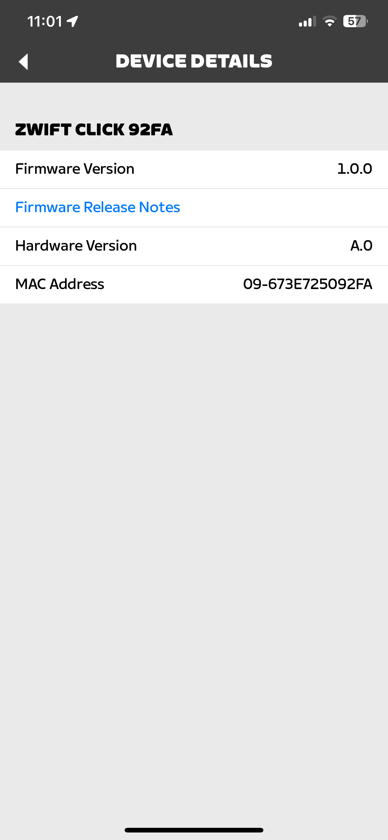

Hello. My Zwift Click is connected to the ZC app. In the ZC the firmware version is displayed as 1.0.0 and i´m unable to update to 1.1.0. Does anyone have the same problem and a solution for it?

The problem is, that the Companion app “says” the firmware version is 1.0.0 and the version is up to date. But the current version must be 1.1.0 and it is impossible to update the firmware from 1.0.0 to 1.1.0 in the Companion app.

I’m running into the same problem. Companion app says firmware is current at 1.0.0 instead of 1.1.0 and does not display the option to update. The Click seems to function fine otherwise, but of course I would like to not run into any bugs if it’s avoidable…

I have the same problem. Click connects fine to the ZC app, says no firmware update is needed, but it’s still on 1.0.0. Additionally, the Click doesn’t connect to my laptop running Zwift. I assume because the Click is still on 1.0.0.
