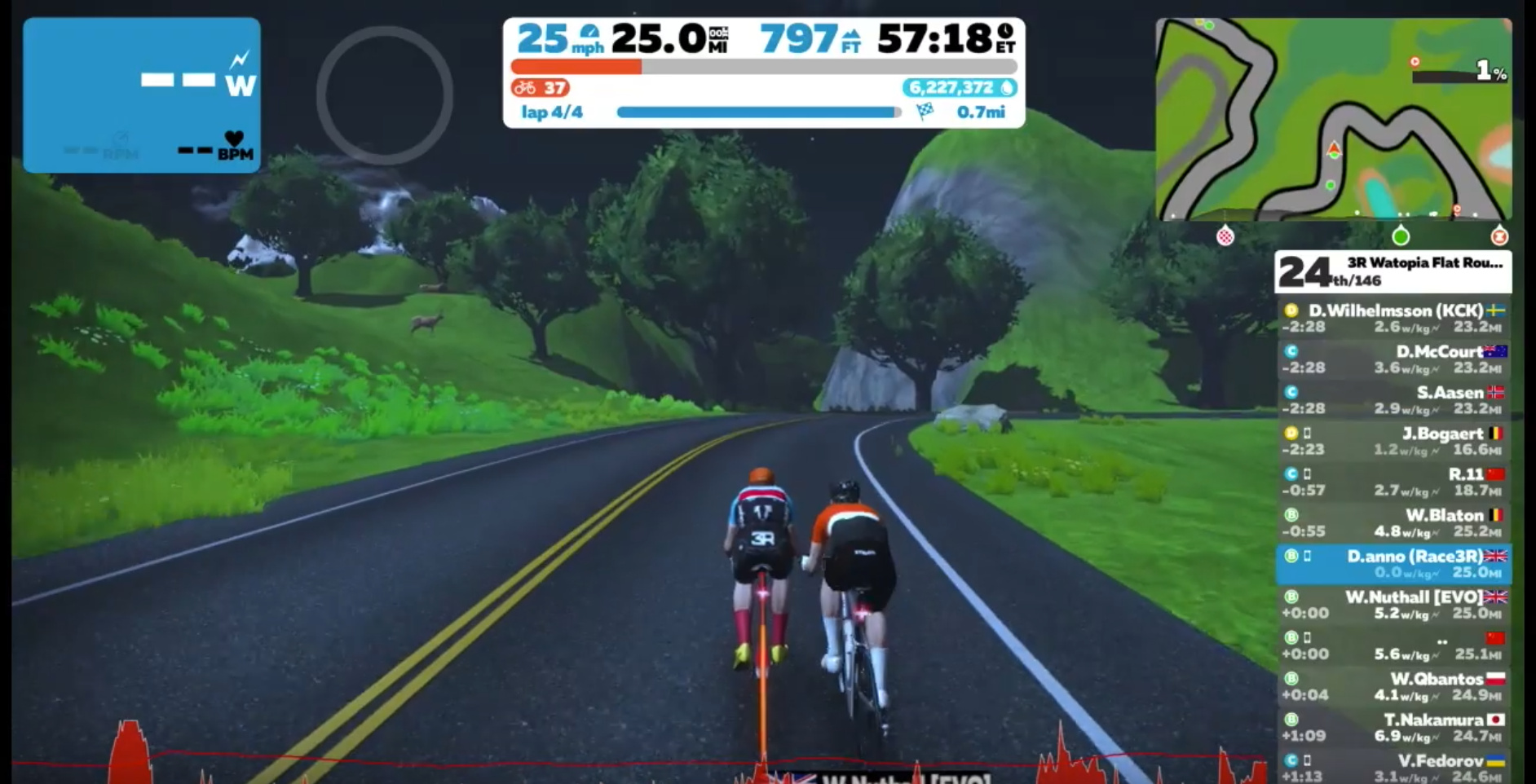

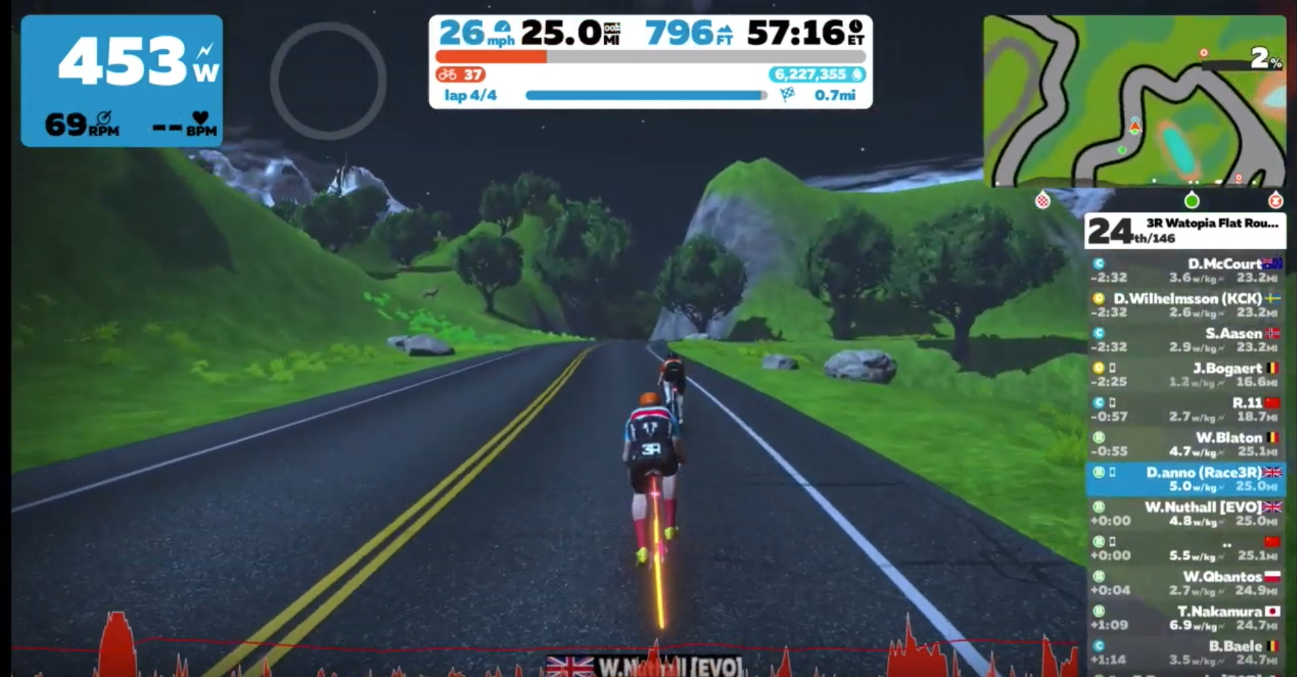

Thanks for coming back to me, so you can see on the graph (attached) that I lose everything right at the end of the ride, I can confirm it was a full drop of all sensors.
I also took a video of the race - YouTube if you skip to 57:50 this is right before it happens. The hr sensor goes first then everything else follows.
