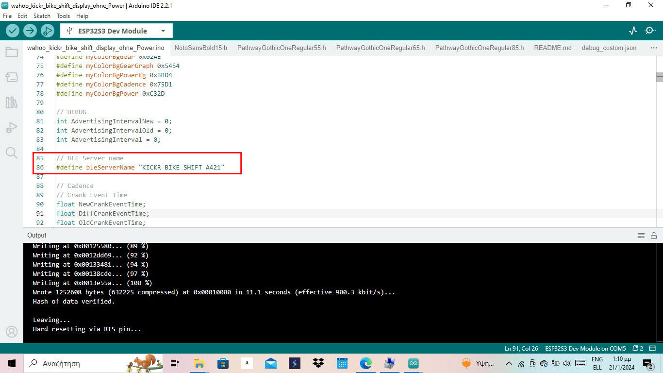

Goodmorning from Greece,
I tried the Franks files and the screen now look like this
I don’t know what is wrong
The board I ordered is that one
h**ps://www.banggood.com/LILYGO-T-Display-S3-ESP32-S3-1_9-inch-ST7789-LCD-Display-Development-Board-WIFI-Bluetooth5_0-Wireless-Module-170+320-Resolution-p-1993268.html?rmmds=myorder&cur_warehouse=CN&ID=6323924
and it match the boards you recommended
I don’t know if that “ST7789” is something different from your boards.
If it matters i tried the process on my laptop with windows 10
Your board seems to be the right one!
Have you edited the name of your Kickr Bike in the *.ino File to the name of your bike (showing up in the wahoo app)? Only then BLE will find the connection! Simply open the *.ino file in Arduino IDE and check it and edit it to the right name, save it and retry the upload.
Line 86:
// BLE Server name
#define bleServerName “KICKR BIKE SHIFT B8EB”
You should see 4 different digits after the name of the bike!
I already did that, it is the only thing that i am sure i did right every time
okay, try to reset your shift bike then and close the wahoo app on the phone.
Unplug the bike from power for a couple of seconds. maybe pairing is blocked…
Blue LED on the kickr should blink and stop blinking after the lilygo is connected to usb power.
I had this also once. after some tries it got the connection back…
Friend I don’t lnow how but I reupload the sketch, without changing anything and it work!
Thank you for your effort and ofcourse the stareat
I realy thank you from the bottom of my heart!!!
Good job! I think your pairing was simply blocked. Thats all.
Have fun with it, and Kudos to streat for programming the Shift compatibility!
