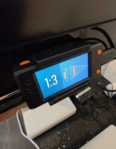

This is awesome. Super happy to have a desktop option to have gear display

So success also by commenting all the stuff out, I do not need:
Also installed a slightly larger Font at 85 for the gear numbers.
Thx again stareat and Kudos for your work and help!

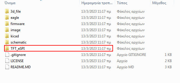

where did you download the TFT_eSPI file?
I downloaded that one
h**ps://github.com/Xinyuan-LilyGO/TTGO-T-Display
because I am sure I have an older version and the wrong one.

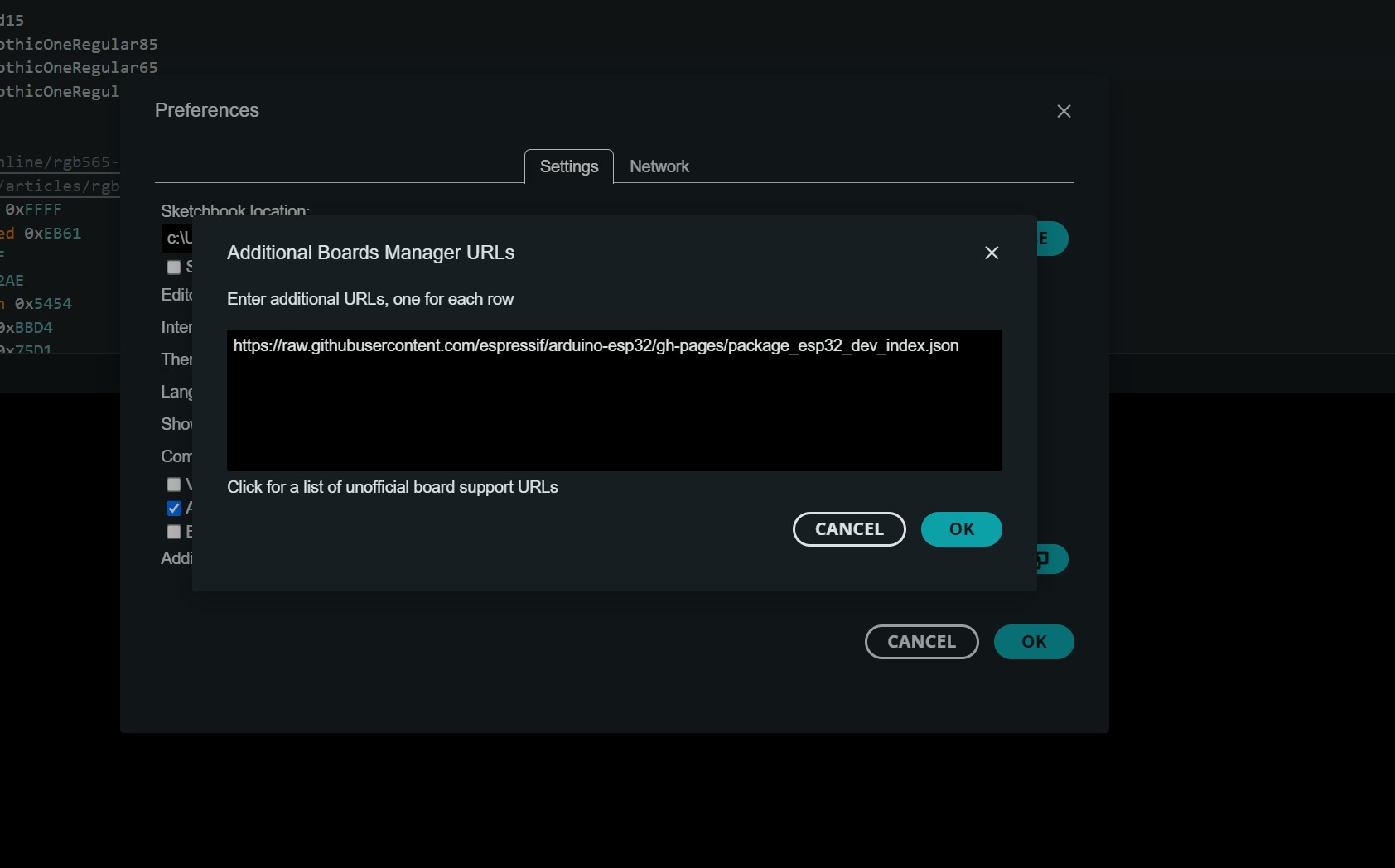

Use the one directly from the espressif repo. (Link in the screenshot!
raw githubusercontent com / espressif / arduino-esp32 / gh-pages / package_esp32_dev_index.json
You should install “Arduino Release v2.0.14 based on ESP-IDF v4.4.6” then via Tools > Manage libraries!
Then you go to the \Arduino\libraries\TFT_eSPI Folder and edit the User_Setup_Select.h file like mentioned above!
Then try compiling and upload again, with the Arduino settings for Board, Flashsize etc. pp. like in the screenshot above!

Friend let me tell you what i do
I install the program arduino ide version 2.2.1
then I go to file > preferences > Additional Boards Manager URLs
I put your link and in board manager DOESN’t have the ESP32 2.0.4 only the 3.0.0 and two other older
so I put the link stareat gives me
h**ps://espressif.github.io/arduino-esp32/package_esp32_index.json
then tools > board > board manager and i Instal esp32 version 2.0.4
what I do with tools > manage libraries you mentioned

and the board looks like this
keep in mind that the board connects to kickr bike shift but the display is wrong.
is it something with scaling because i checked the resolution is 320x170
thanks in advance
