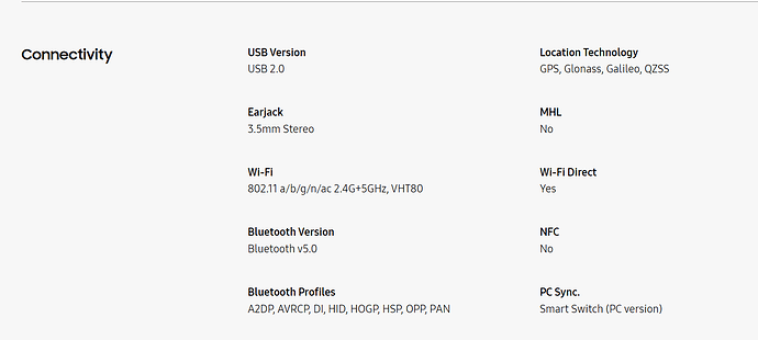

You may want to check the specifications on your Samsung devices to see if they have an ANT+ radio. Samsung hasn’t included an ANT+ chipset in their mobile devices in many many years.
The Tab A8 tablet for example, does not list ANT+ support.
Without an onboard ANT+ chipset, there will be no connectivity to ANT only sensors. Is your cadence sensor a dual-protocol unit (meaning Bluetooth and ANT), or is it ANT only?

I was seeing the Ant + button live on the screen so I assumed all was OK, but I didn’t realize that the Tablet was unable to read the sensor and that I had two Garmin sensors with different properties.
I have swapped sensors and installed on the Zwift bike the one Ant+ & Bluetooth and all is OK by now!
