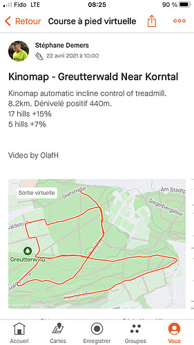

Hello, I have the newer HORIZON 7.8 AT (late 2020), and it connects and works flawlessly with Zwift. No fuss, easy setup and the speed seems super accurate (all things considered). As this treadmill is compatible with Kinomap and there is INCLINE control on that plateform, I truly hopes ZWIFT RUNNING will provide this, so we can have a more realistic experience. In the mean time, I will try connecting through RUNCLINE to see if Zwift will control the incline automatically.
@Steph_Dem is the incline set on the treadmill recorded to the .fit file and passed through to strava so you get your incline and height meters there?

Absolutely! Links to Garmin as well… complete stats, just like an outdoor run on my watch.

No Runcline… just Kinomap linked to my treadmill (Horizon 7.8). Run is imported automatically to Garmin and Strava with all data
