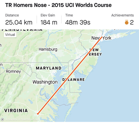

The distances weren’t messed up for me but this was the map view I got on Strava from Monday’s ride. I started in NYC and then went to Richmond for a meet-up.

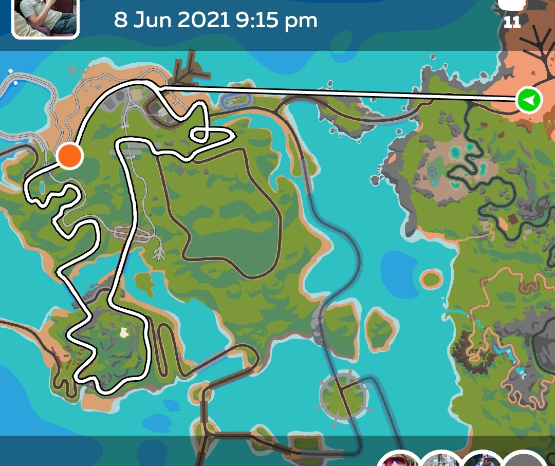

Guess what? This happened today on my ride.
Warmed up on 2019 UCI Worlds Harrogate Circuit then the meetup was in France. The two activities got combined into one fit file.
Activity:
@Ken_Kress @Gerrie_Delport_ODZ @Robbo1234biking_B_ST
