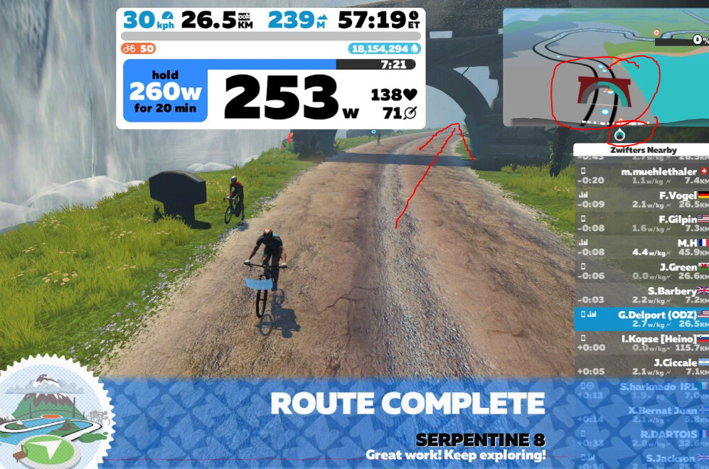

You should see the arch on the minimap. See the image below.
Have a look at this video, at 35:01. The arch is either just after or just before the caves, depending on which direction you’re travelling.
