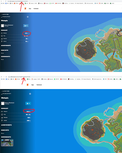

I rode the Watopia beach Island loop today for first time. 5.2km in, dropped out. Resumed activity - completed ride at 13.2km. Zwift has logged this as 2 separate rides (each have individual activity references) HOWEVER - only the shorter ride uploads to STRAVA. Exporting the FIT file for the longer 13km+ ride results in a duplicate activity error. Altering the start time using FITTOOLS allowed me to upload the “longer ride” - however STRAVA shows it identical to the shorter ride! Super frustrating as it was a good workout and I was happy with my progress only for it not to register. Any ideas?!

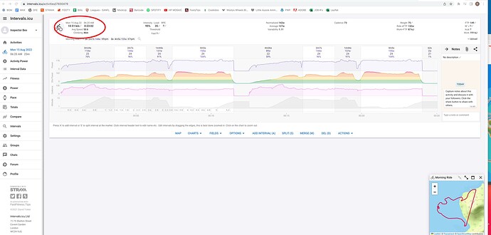

Hey Dean many thanks for the reply! I have downloaded the 2 x FIT files (confirming Zwift records them as different activities with differing distance in screenshot below) - and joined them using FIT File Tools. Uploaded to ICU - and it’s registering the ride as only a total of 2 x the 5.25km ride. The issue is clearly that the longer activity has only registered 5.25km - am at a loss as to how to resolve this…v frustrating as the Leg Snapper KOM segment was brutal on that loop!
Oh bugger. That just looks like two of the same fit file joined up. I think Zwift means well with the whole “continuing ride” feature but have never really polished the solution when they introduced it a year or so back to provide cohesive solution for those of us that use 3rd party tools like Strava/Intervals etc.
I’m a bit stuck at this point sorry Rebecca. I totally get the frustration.
