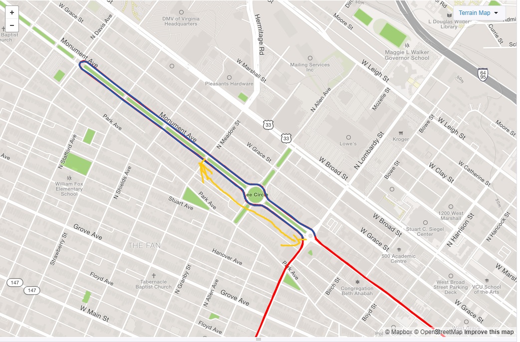

there is a bug in Richmond, the cobblestone effect is switching to tarmac (so no roadfeel) but the road is still cobblestone in Zwift as before , from N Meadow Street till to the First English Lutheran Church (apprx 600m).
here is the map , the blue line is the faulty segment:
BR,
Andras

Maybe i wrote it wrong, the road surface is brick for this entire part (blue line) in the Zwift, but from N Meadow St till to the right turn (where is the church) the brick roadfeel is stopped suddenly and switched to normal (yellow part) but visually it is still the same road surface as was before.( the direction is counterclockwise, i dont know in clockwise direction the situation is the same or not, i didnt try it)
I’m using ANT+ and 1.0.45663 is the latest version… Maybe it is only ANT+ bug or only Neo1 related or Win bug, but it exists for sure :slight_smile:
