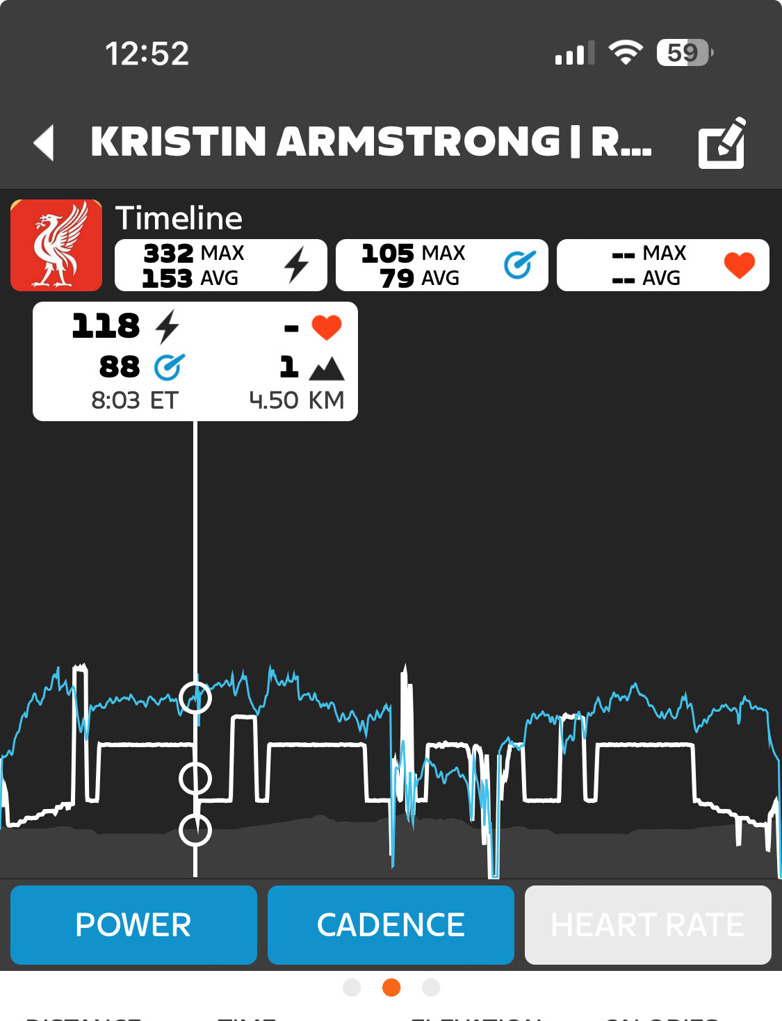

Hi, on Apple TV 1.77.2, kickr v5 4.3.0.
Done my first 2 race ready training sessions. After half way on both the trainer resistance tries to put up a 57% gradient hill, then releases and this continues for most of the rest of the ride. It’s happened 2/2 times. Awful experience. I tried a normal route after and had no issues. Is this just me or a common occurrence?

It did say connection dropped on one of the cycles but not the other. I powered off the trainer and restarted. Why does it happen on trainer mode only?
