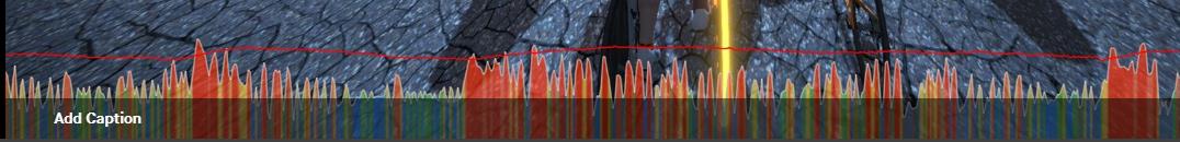

I think this can´t be normal. Any suggestions to solve this problem:
Measured with P2M via ant+ , controlled by Tacx Neo 2.

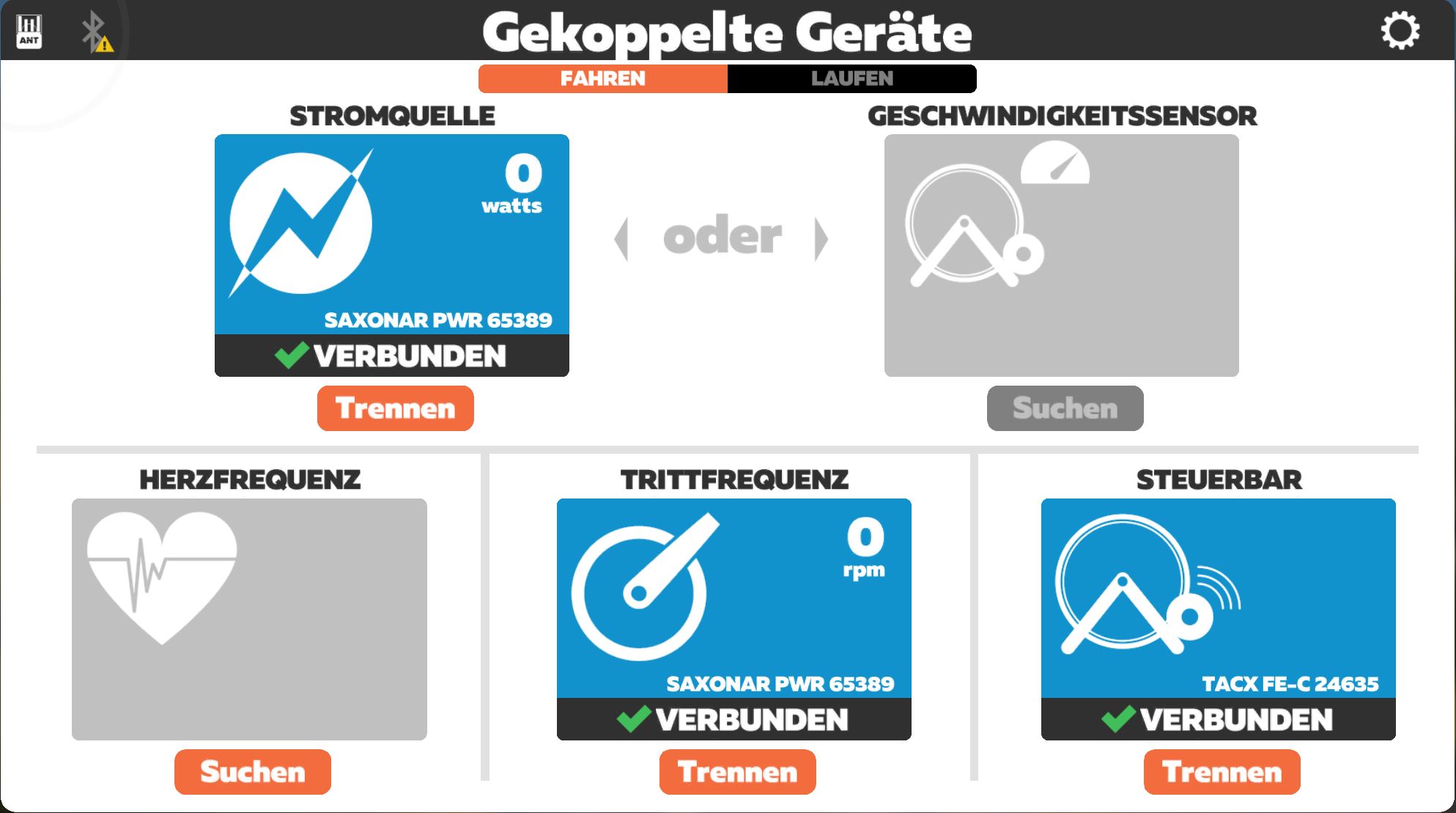

check that you have the latest firmware also use the ANT+ FE-c option for power if that is available.

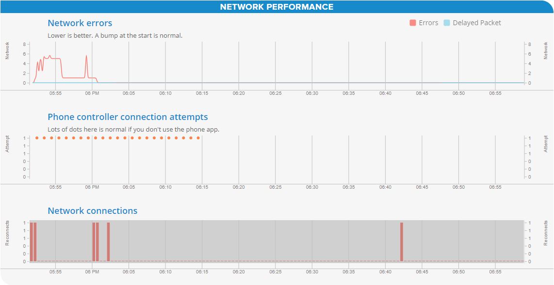

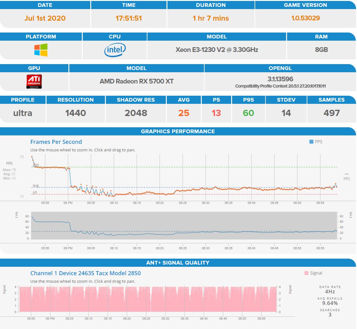

You can put your log file in zwiftalizer.com and see if it is dropouts.
Here the logfile. BTW poor frame rate for a 5700XT :thinking:
ANT+ FE-C is not available
ant+ fe-c is only for trainers, so wouldn’t be there for a separate power meter
A bit of useless trivia for you is that FE-C stands for ‘Fitness Equipment Control’
I would suggest dropping your resolution, so that your p5 don’t drop below 20fps that maybe the reason you are getting power fluctuations.
Graphics problem is fixed, Zwift was windowed and I switched it to full screen. Now I´m getting stable 50 frames. But the main problem is still there.
