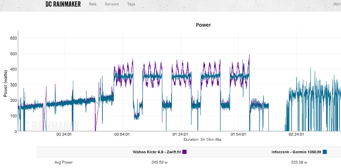

Oscillating power reading from Wahoo Kickr 6 in free ride mode
This image is from DC Rainmakers comparison tool, showing the watts reported from Wahoo Kickr 6 vs my bikes Infocrank powermeter. As can be seen, there is massive oscillating power readings from my Wahoo when in free ride mode.
The setup:
  • Wahoo Kickr 6 connected via wifi to Zwift.
  • Virtual shifting used in free ride mode
  • Zwift running from PC
  • Bike power meter: Infocrank (dual sided power meter) connected via ANT+ to Garmin 1050.
  • The whole file was recorded in one go with no change in setup, only changing in and out of ERG mode.
  • The last hour can be disregard. This is me doing some warm-down outside with only Garmin 1050 connected.
  • Zwift, PC and Wahoo firmware 100% up-to-date.
The first part of the ride was a ramp with ERG mode enabled. Watt reading from Wahoo is stable, and on similar level as the reading from the bikes powermeter.
Then followed by 5 x 10 min with ERG mode off (eg. in free ride mode) on Alp de Zwift. In free ride mode the watt reading from Wahoo is clearly oscillating wildly. There is 150 watt from top to bottom of the curve, so quite significant. I notice that the period of the oscillation is quite constant with around 4 peaks pr. 10 minutes. I did not feel any change i resistance, other than what matched the Alps change in gradient. This is also kind of confirmed by the rather stable power readings from the Infocrank
Wahoo Support have asked me to make a staircase test via their App in ERG mode. I have done that, and it confirms my own experience that everything is fine when in ERG mode. After that they closed my support case. When providing another comparison test (the one above), the asked me to run another staircase testing via the App in ERG mode… again. So we are not really going anywhere at the moment.

I have had it for 1,5 years, but have not used it for a while. I was only 4 weeks ago that I restarted structured training indoor. In the beginning it was 100% interval training in ERG mode, but when pushing high watt standing I struggle to perform when in ERG mode. This is when I decided to do some part of my training on a slope in free ride mode. As you can imagine it was completely impossible to hold my target power, as the reading went up and down.

My gear ratio were around 2:1 when doing the free ride, so apparently this is too low. Unfortunately it rule out the small chain ring that is more silent to use.
Tomorrow I will use the big chainring, and hope that the issue is then gone.

I use my road bike with normal cassette, but since it is only fitted with 11-28 cassette at the moment, I rely on virtual shifting when training on steep sections.
When I made the comparison attached to this thread, I was likely on 34t in front and 18t in the back, so ratio 1,9. Next test will be on 50t in front and 14t in the back, corresponding to a ratio of 3,6.
I haven’t had a clue about these limitation when using virtual shifting, and from what I can read it is important to stick to the same gear-combination throughout the training - if I get it right.
Normally I will do my training 100% in ERG mode, and use the small chain ring due to lower noise level from drivetrain. But when working high power and low cadence, the Wahoo is simply unable to keep watts at the needed level. So I tend to put it on large chainring when doing those sections. It works OK as long as ERG is controlling the power, but with this knowledge I should probably stick large chainring when the training includes sections where I will go in free-ride mode and use virtual shifting.
