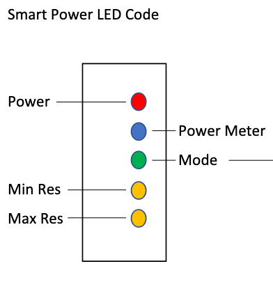

I’m an experienced Zwifter with over 8,500 Zwift miles on my setup - nearly all of these miles were logged with my InsideRide rollers accessing Zwift through Apple TV. The rollers have a resistance unit called Smart Power and its always worked fine via Apple TV. Since that 12/30 update (which I installed after my workout on 12/31/21), my devices connect normally, but my rollers won’t respond to resistance changes from Zwift. Now I have only 2 modes… minimum resistance or maximum resistance, whether ERG mode is on or off.
Minimum resistance occurs for any grade up to 3% (including negative values), then when the grade on Zwift goes to 4% or above, the trainer switches into max resistance mode. There are yellow lights on the unit for MIN and MAX so I’m certain this is happening (I’ve attached a screen grab)
This identical behavior occurs with Apple TV and with an Apple laptop which also has the most recent software update. I’ve written to Inside Ride about this and they don’t have an Apple TV to test it. Again, everything worked normally until that 12/30 update. I was hoping to find another user of these rollers with Apple TV so we could compare results.

I took a few days off and tried again this morning. Still no luck. I have an Assioma power meter connected to the rollers, then the rollers to Zwift as power meter and controlled resistance, as you do. In ERG mode, as Zwift requests more resistance from the rollers, nothing happens, and the yellow MIN resistance light stays on. If I just do an open ride the MIN resistance light is on for grades 2% and below but once the grade goes to 3%, the MAX light goes on, until grade drops back below 3%. Its such odd behavior from a product that has been great for years.
