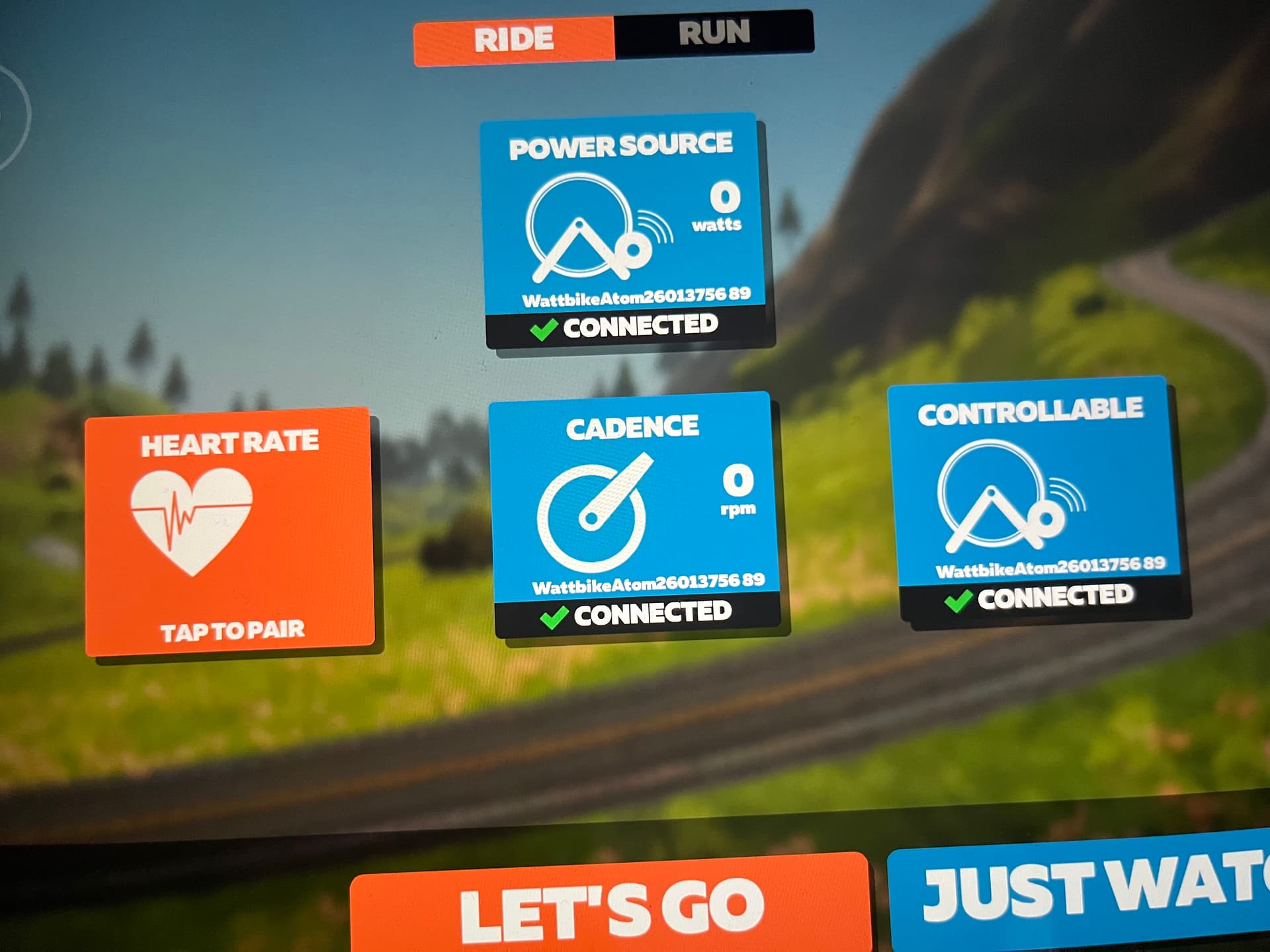

Major issues with Bluetooth, ATV and a wattbike atom this morning in the household. (Not me, I woke up to a seriously pissed off partner)
Getting an error saying need to wake devices. Connected fine to IOS/IPad after person had spent an age trying to resolve ATV issues so not end device issue.
To follow up on the above…
ATV no longer finds device
IOS finds it instant
Tested with 30 seconds of each other, Atom was not connected to iPad when failing to connect to ATV
ATV
IOS
RGT working fine on sane ATV
@shooj is this a known issue, how is this overcome?
