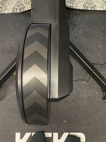

My Kickr Bike arrived yesterday and the flywheel is rubbing against the plastic casing on the drive side. It looks like either the casing or the flywheel aren’t on straight as the gap goes from nothing at the front of the flywheel to 3mm at the rear (see photo). Can anyone tell me what it looks like on theirs?
Wahoo have offered to replace it but if it’s a simple fix then i’d be inclided to do that instead.

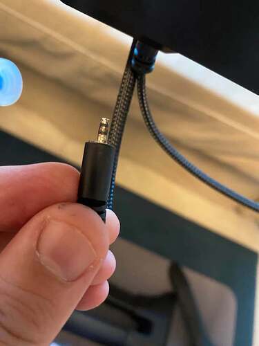

Same error with shifters also. When disconnecting the pin and trying to connect it back I discovered half of the connector was broken inside.
Poor built quality!
