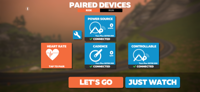

In the paring screen you need to pair as Power source and controllable.

Hi B_CN,
Don’t think the difficulty was set to off. Herewith the screens.image0 image1 image2
