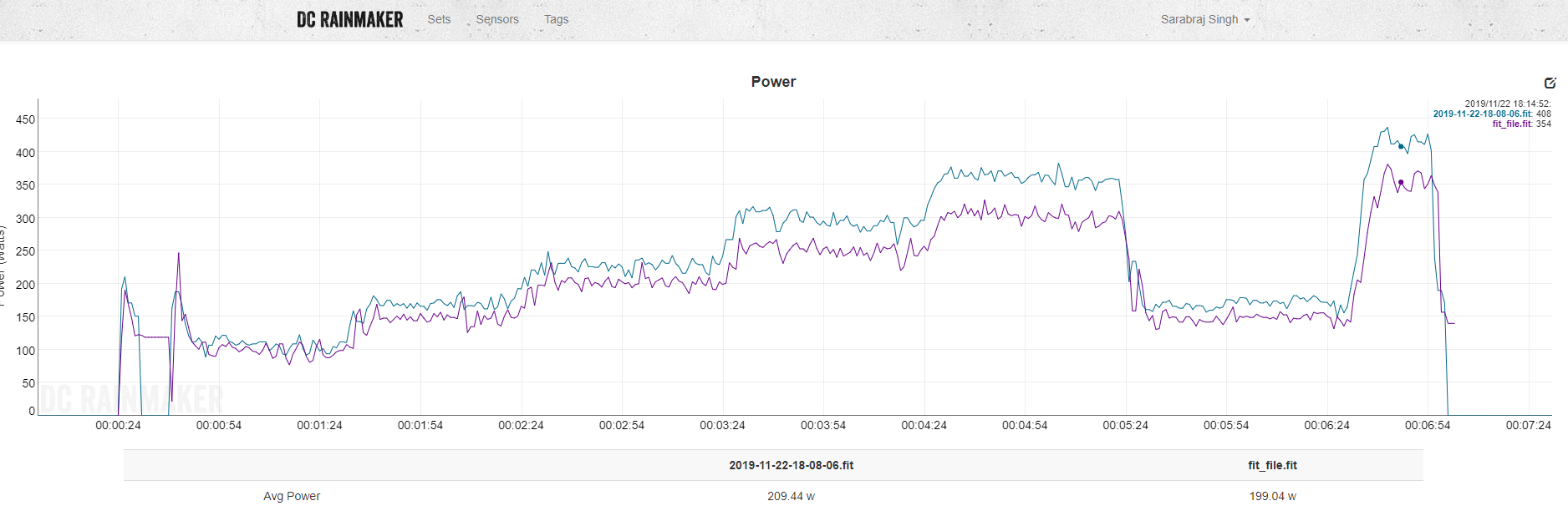

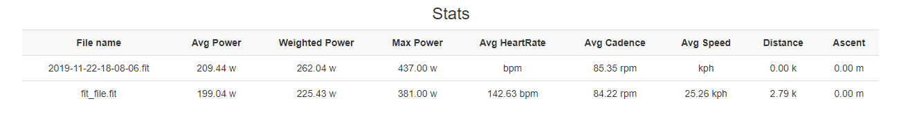

I was struggling a bit too with the 300 and 350w intervals, because I was actually doing around 350-430w. I took a break around the 05:24 mark and started the “350W” interval at 06:24. I ran the numbers through DC Rainmaker’s Analyzer tool and here are the results.
Turquoise - Garmin 520 + Favero Assioma Duo’s (firmware 04.04)
Purple - Elite Suito Power (hardware revision 1, firmware 191)
that max power difference ![]()

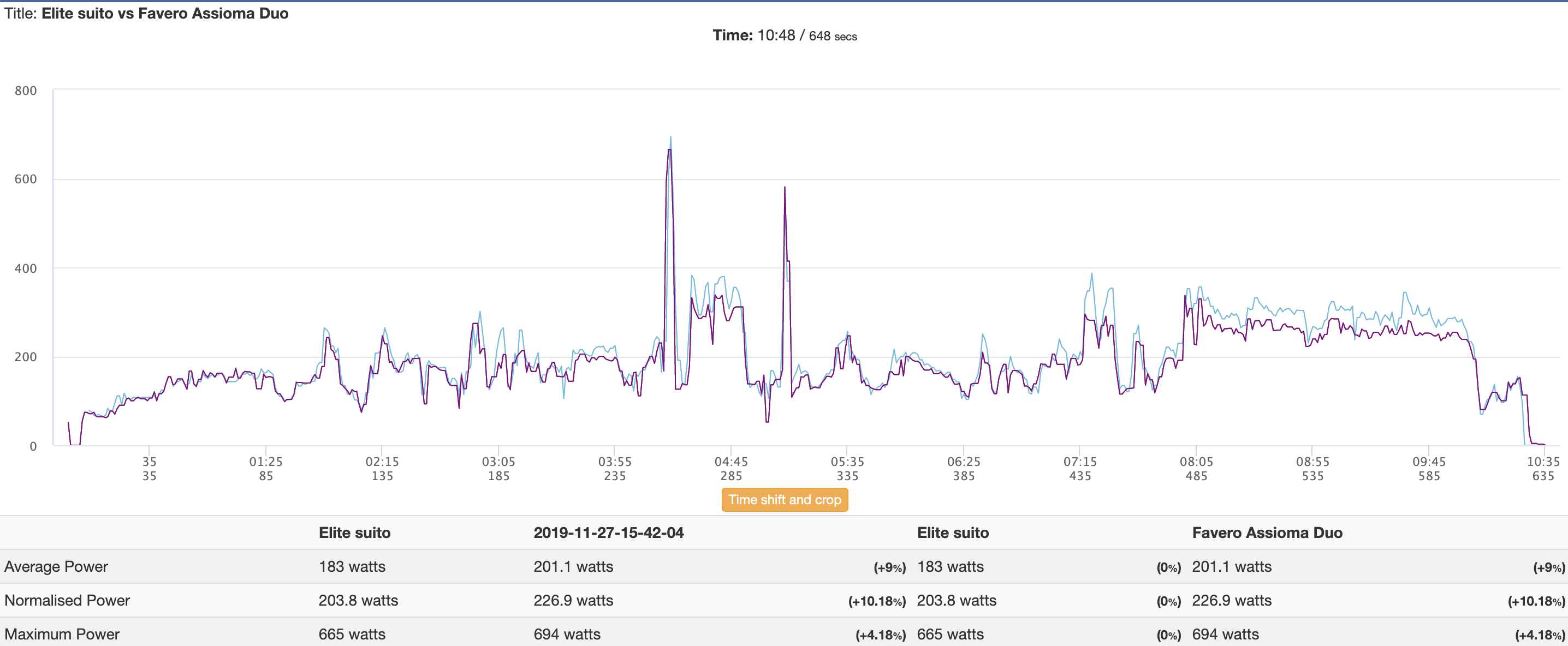

Hey guys,
I bought Elite suito and I have the same issues as you have.
What I did is 2 sessions of 10 min with assioma duo pedals and my elite suito trainer. The first ride is a 10 min free ride. The second ride is 10 min in erg mode starting in zone 1 for 2 minutes then going up to zone 2,3,4,5,6 every minute and finishing the last minutes in free ride mode.
But before starting, I calibrated assioma duo pedals twice.
I also did a spindown calibration of the trainer before the second ride
As you can see, quite a big difference when riding Titans grove (ride 1)
In the ride 2 in erg mode, the more power I produce, the more difference in power there is between my assioma duo pedals and elite suito …
I’m in contact with the Elite support, I’ll tell you what they say to me

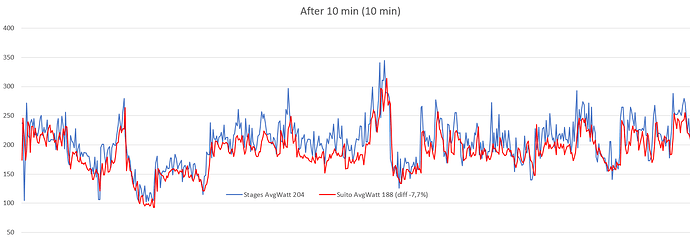

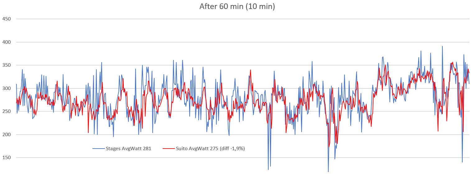

I have done some testing with my Suito (standard firmware) vs Stages (single left).
It seems that the accuracy gets better the longer time it has run (the warmer the trainer gets).
At the end (after 60 min) the results are very similar. An additional remark is that I am left legged.
Se the results:
After 10 min I made a spinndown off the Suito and a calibration off the Stages.

definately better after a warmup. sucks that you have to ride a solid 60min before you get consistent-ish data.
