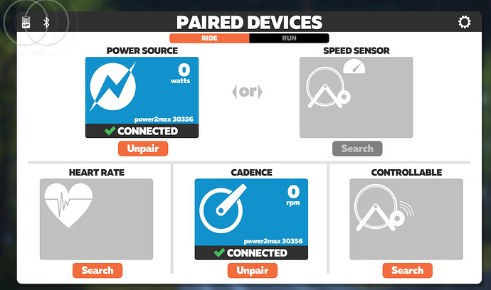

You made me curious, so I tested with my MacBook Pro (also 2015 w/Mojave) With Bluetooth enabled, ANT+ had no problem pairing as shown below. Also note both the ANT and Bluetooth icons are radiating rings.
Since you tried two different MacBooks, the next best suspect is the USB dongle. What USB dongle are you using? Have you used it before? Are you sure it works?
