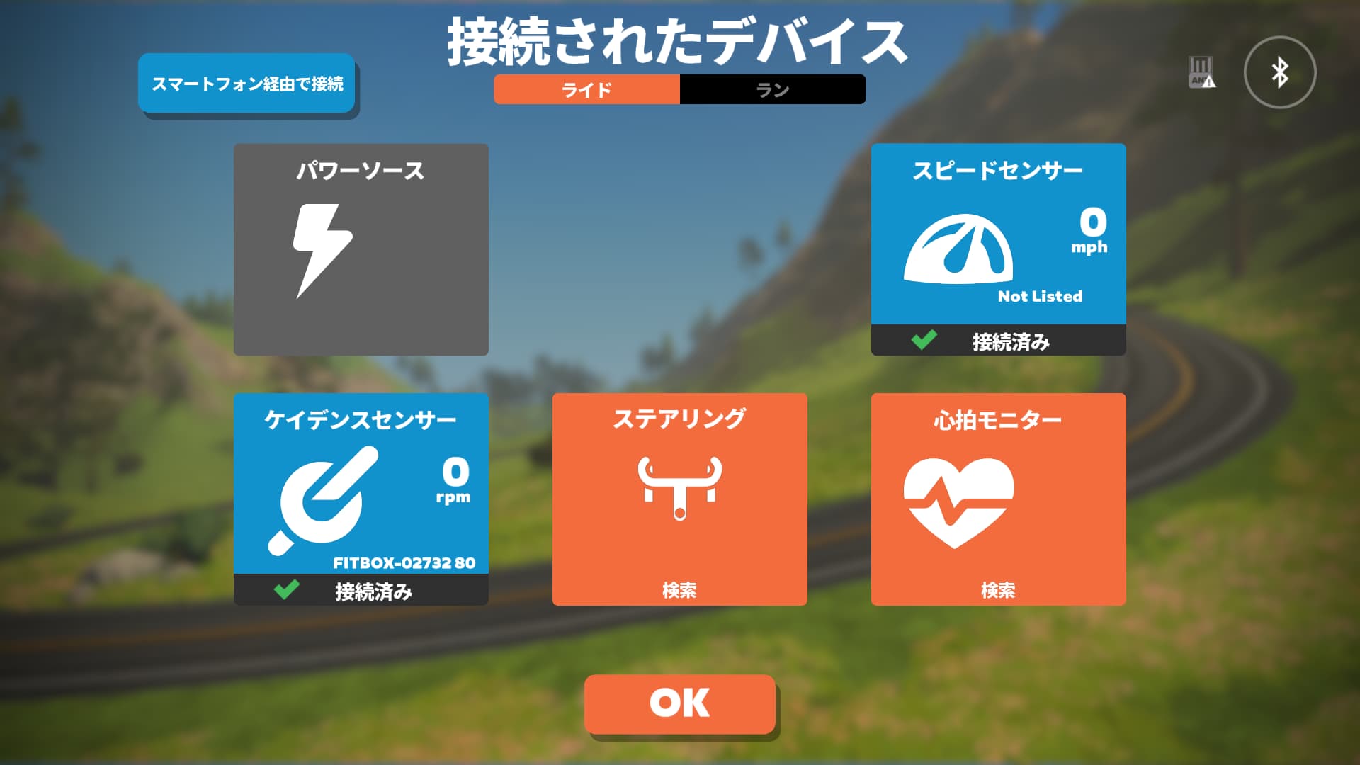

By the way, yesterday I played a game with Bluetooth, but when using the companion app,
I don’t use Bluetooth connectivity, do I?
If the companion app is available,
Does the upper left part of the attached image show some kind of reaction?
I will wait for your reply.
Hello Taro and welcome to Zwift.
To answer your last question first: no, there isn’t any reaction visible on the pairing screen if the Companion app is working and on the same network. That option at the top left of the pairing screen is for using your smartphone to act as a ‘Bluetooth bridge’ for connecting sensors to Zwift, but since you have managed to connect the speed sensor and the cadence sensor directly, you don’t need it.
