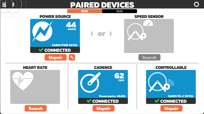

I tested it and I paired my trainer as power and controllable and my power pedals as cadence
EDIT: This won’t work with only bluetooth, bluetooth can only link to one sensor.

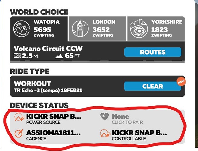

I paired devices as shown in the screen grab above but when I went to choose a route and workout…and ensured erg mode was selected, I got this setup instead. I’ll try it today and see if it works.
