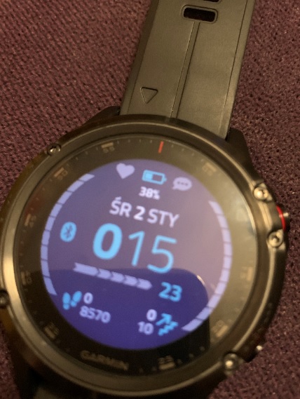

I would like to connect Garmin Fenix 5 Plus to Zwift app to see Heart Rate but unfortunately Zwift is not finding Garmin watch.
Devices which I have:
Trainer was connected with Zwift, as you can see on attached screen. For sure Bluetooth on watch is also on. Garmin is connected with Iphone. Application Garmin Connect recognize it without any problems.
I just read that Apple TV can only connect to Bluetooth devices…but sth not working…in my case.

Hey Adam, your Garmin needs to connect straight to your Apple TV 4k or through the Zwift Companion app.
When you said your Garmin is connected to your iPhone did you mean through the Companion app?
Hello Vincent,
To be honest Garmin is paired only via Garmin Connect application, that’s all.
Most probably the case is that I would like to transfer HR directly from wrist heart rate monitor. I didn’t have any other hate rate monitor on breast.
Could You please share with me instruction how to connect Garmin directly to Apple TV.
Cheers Adam
Most probably the better option will be when I’ll buy heart rate monitor on breast with Bluetooth…I’m considering such a solution as well.
The Garmin does not support BLE as far as I am aware, it is ANT+ only and so will need to bridge using something like the CABLE dongle.

Garmin broadcast HR over ANT+ and Apple TV is bluetooth only so It will not work.

My solution was following …I bought additional heart rate sensor which supports Bluetooth & ANT technology.
It’s Wahoo Tickr ( I have following, but I’ve checked on Wahoo site and there is a new with different design.
http://www.iphonology.com/420-wahoo-tickr-x-connected-heart-rate-monitor-strap-and-more/
Just to sum up.
During virtual ride I Use, Apple TV, zwift & wahoo tickr.
During regular ride outside, garmin + wahoo tickr.
