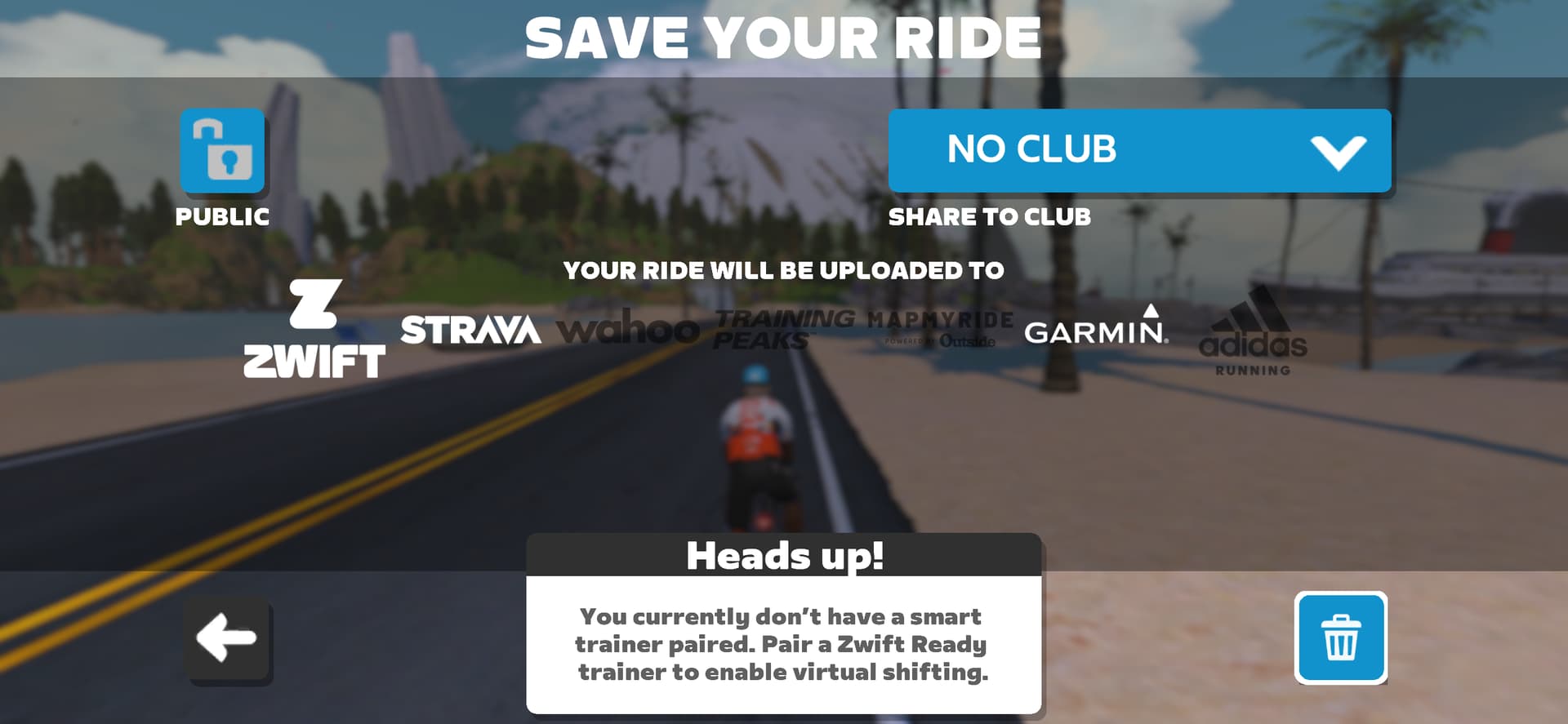

I have an issue with my left Zwift Play controller.
When it’s switched on I get a recurring pop up message (titled “Heads up!”) telling me my trainer doesn’t support virtual shifting.
When I turn off the left controller the message stops showing.
I’ve tried soft and hard resets for both controllers, the firmware for the controllers is up to date and I’ve recalibrated them but it still persists.
Does anybody have any thoughts on a solution to this please?

Running it on a Samsung Laptop.
Also tried it through the iPhone and got a slightly differently worded message.

Hi @_Tommy_Vultures , welcome to the Zwift Forums! I’m sorry to hear you’re seeing this message unnecessarily. It should only be seen if you press the side buttons on the Play controllers when in a free ride on a trainer setup that doesn’t support virtual shifting.
If you’re not pressing the side buttons on either of your Play controllers before that message pops up, we may want to take a closer look at your controllers. Please feel free to contact us in Community Support for further assistance!
Thank you. No I am not pressing the buttons and it is occurring on all rides. I will contact Community Support. Thanks
