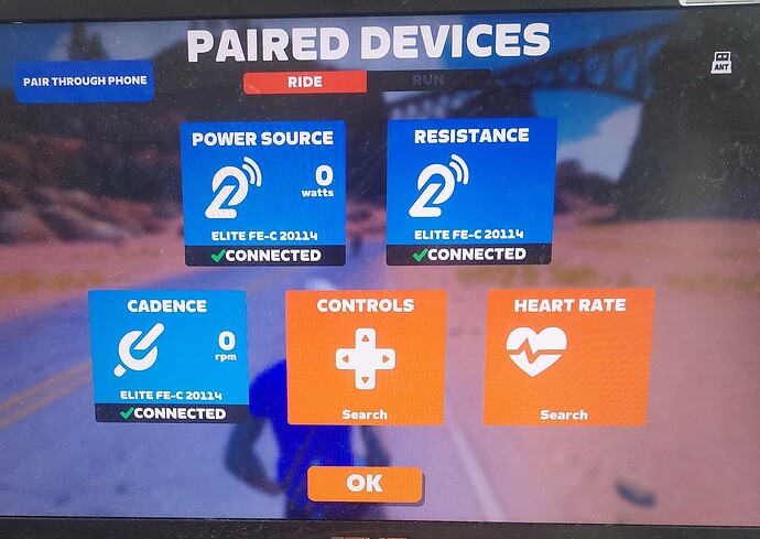

I just uploaded my current pairing setup for you guys to see.
  • Tried without bluetooth on, no sucess,

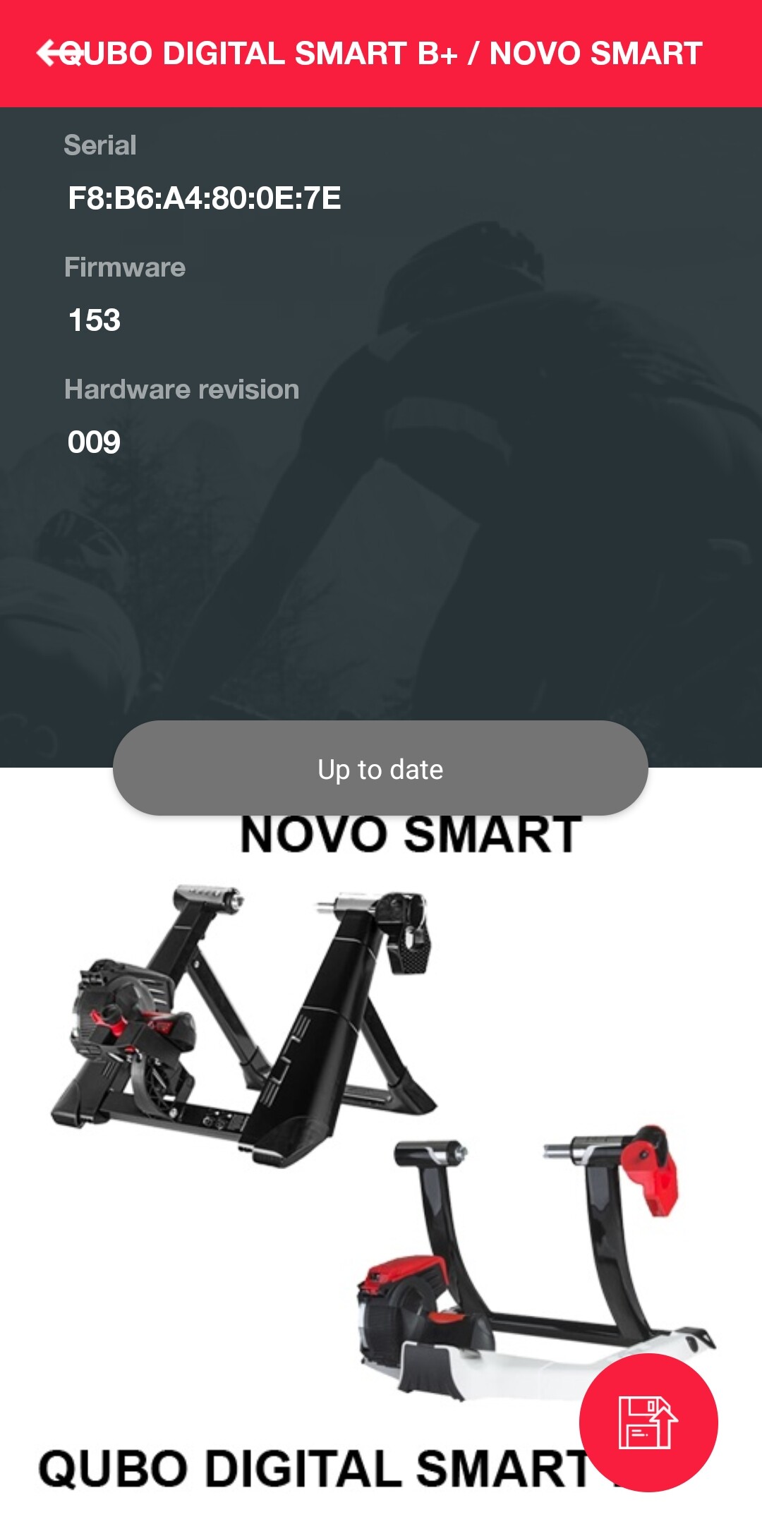

  • Checked the firmware of the trainer, also in the images, no issues,
  • Tried changing the ant+ to another bluetooth slot (all of them are usb 3.0 and its the same laptop as before), no luck,
  • Tried changing the power to connect via bluetooth and the resistance (old controllable option) via ant+, no luck.

I see the one time you logged in with the Power signal paired via Bluetooth and Resistance paired to ANT+. and uploaded that log file to Zwiftalizer for analysis. This is the interesting part:
Would you try unplugging the ANT dongle from the PC entirely? This will force all pairings over Bluetooth. Let’s see if that makes an improvement.
Side note: going back to your server logs from 2021 - I’m seeing an unusual pairing habit. You used ANT_+ to pair your Power and Cadence, but the Resistance signal was not paired at all. Was that intentional on your part, or were you not aware that was happening? If you didn’t know - I have further reason to suspect something’s wrong with the ANT transmissions.
