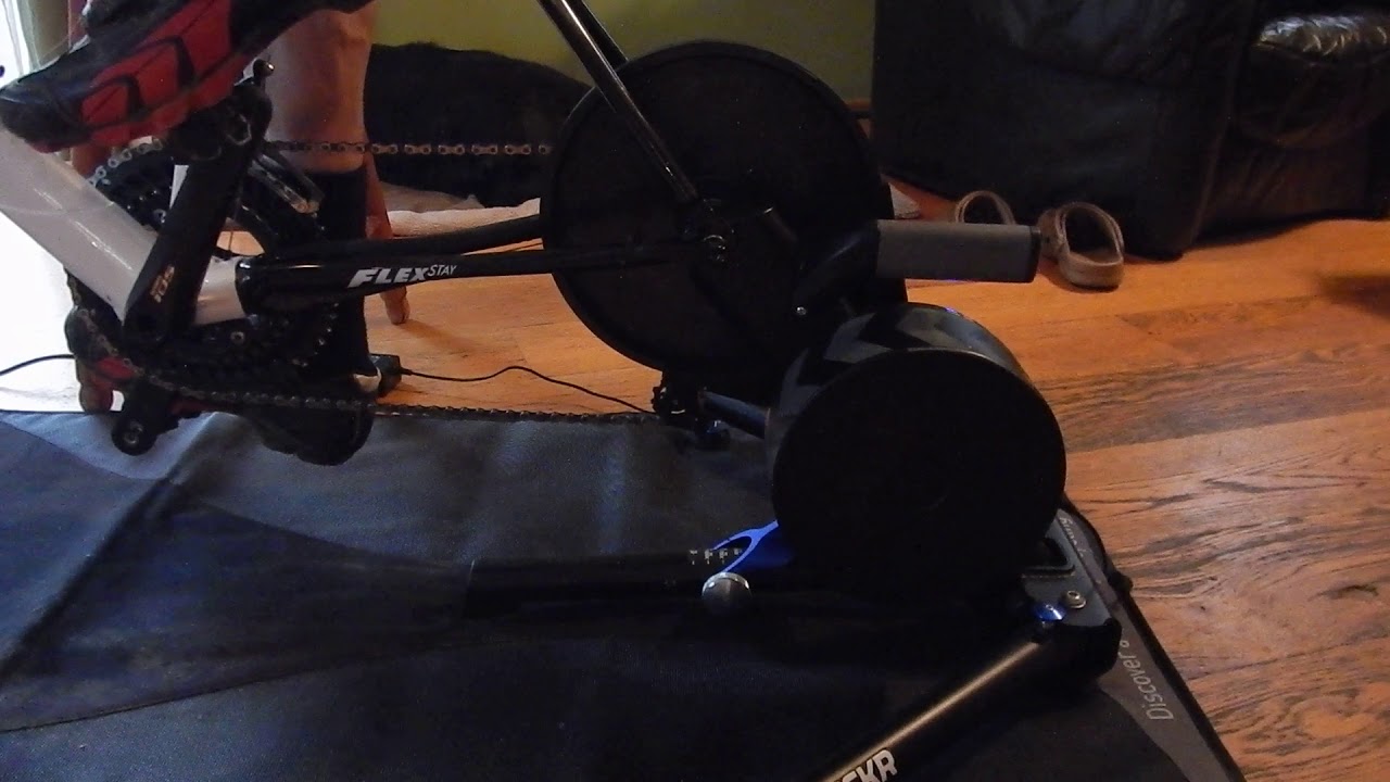

Day and Night. As soon as I plugged the Neo in it was already connecting to all sensors. I was literally surprised when I looked up at the monitor and saw everything was connected. Wow. It was a battle with the Kickr. I almost had to break out the tin foil to get a connection. You old timers will know what I am talking about. :slight_smile: So far I am impressed. I see two differences. First I am riding a mountain bike and only have a 28 tooth front chain ring. The response on the flat with Kicker was that the cadence went up more than real world with almost no resistance. With the Tacx Neo it felt more real to life in the cadence and resistance. I only rode about five miles so don’t take this as gospel. A couple times I sprinted to catch up with a faster rider 500+ watts. What I found was, when I got off it and tried to go to a lower cadence and power output the resistance stayed higher than real world. I haven’t even read the manual for this thing so I could be doing something wrong. So far I am happy with it. Remember, I am a newbie and only road it five miles.

Update for Godmother_Fox My Neo is working well, Using a mountain bike with a small chain ring limits my speed on the flats but is fine on the hills in Zwift. Getting the hang of it now.
