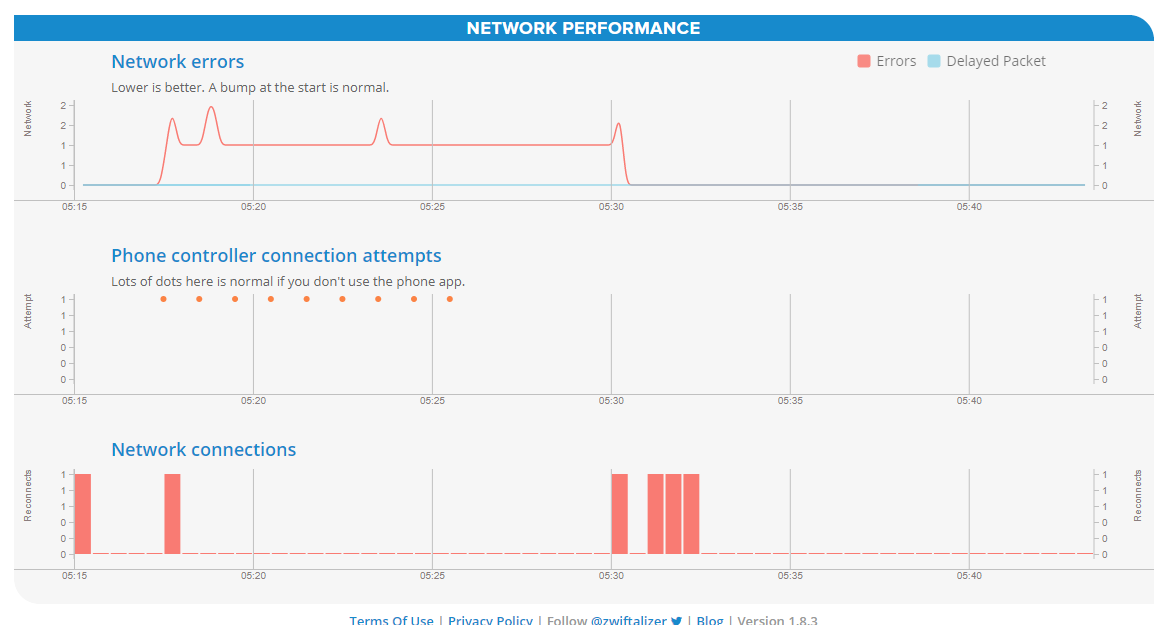

I looked at your partial log files on our server from today, and noticed 4 login attempts. I uploaded each log.txt file to zwiftalizer.com, which is a third party site that diagnoses issues with your session.
Login #1 shows both sustained network error and weird ANT+ connections, which would cause both of your symptoms.
The subsequent logins had network weirdness, but ANT seemed ok. You can verify for yourself by uploading your log.txt files to zwiftalizer.com. Here’s where to locate your log files
