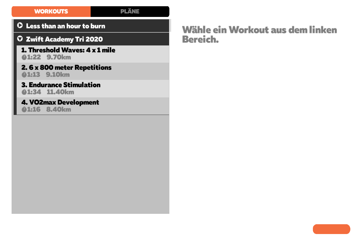

I then launched Zwift on my IPAD Pro.
Went to taining / workouts - at least there was a custom training folder, but with anything else inside than my Trainingpeaks workout.

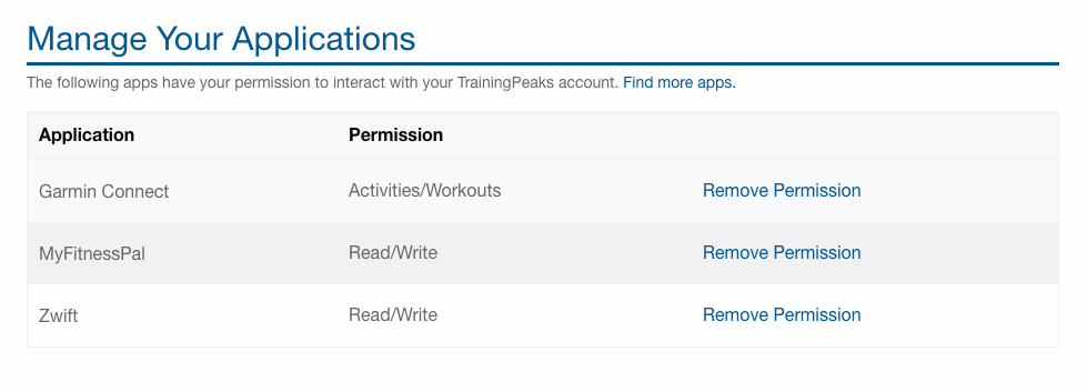

I already deinstalled all Zwift and Trainingpeaks Software on MAC / IPAD / Android phone. Logged out from all Zwift and TP online websites. Reinstalled, logged in again - NOTHING.
What am I doing wrong?
I also have connected zwift to Garmin Connect - but it disconnected garmin at the very beginning of the process when I reinstalled everything. So thats not the issue.

RUNNING STILL DOESNT WORK!
I moved a running workout to today’s TP plan. Hit refresh button at TP.
Then opened Zwift / running / training / workout and nothing.
So it doesnt import the custom running plan from Trainingpeaks.
Only the cycling plan work.
53
Running workouts only seem to work if they are by distance and not time and they are set with a % of threshold pace.

Ah ok thx - so I will try to give them a distance and pace.
Sorry but whats the % of threshold pace?
I gave my TS workout a distance and a pace. But no effect of ZWIFT.
'% Threshold pace 'is one of the options when you are building the workout in training peaks. Also, the workout only seems to appear for the day it’s scheduled - tomorrow’s workouts don’t appear in advance.tp
