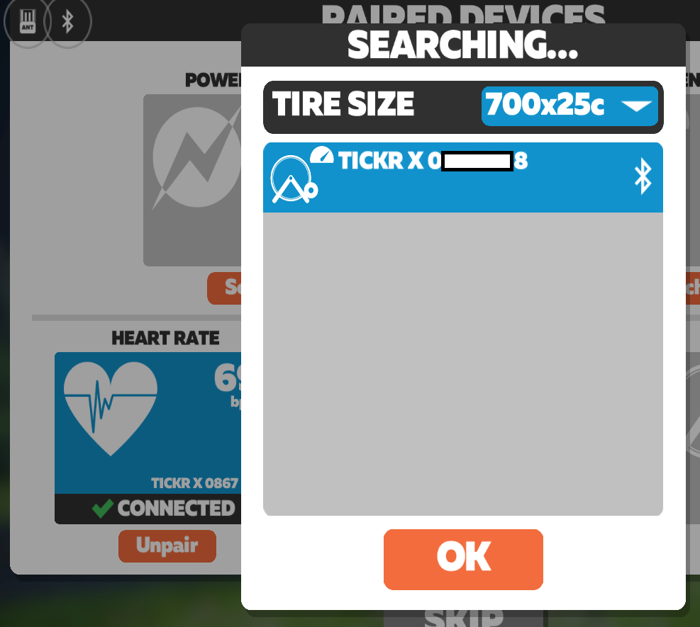

My Tickr X’s run speed and cadence are still not recognized in Run mode.

As you can see in the image, TickrX is recognized in Bike mode. It is not recognized in Run mode.
In the Wahoo application, it is correctly used as running speed and running cadence.
That is truly odd. First time I’ve heard of post update issues. Have you submitted a ticket?
