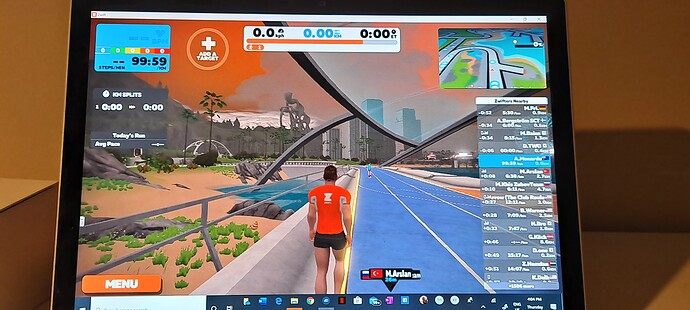

All calibrated and update on Runn (configirez app)completed. Will not calibrate in zwift. When showing 10 on treadmill zwift 3 point calibration shows 0.5kmh. Avatar wont move with 99.59km flashing showing in speed. Pictures attached. Have completed one introductory run worked once and have signed up for monthly. Any help greatly appreciated. Wifi and bluetooth connection are good.20210114_160502|690x310

The RUNN comes calibrated from NPE at 5mph. If you re-calibrate through the Configurez app, you are simply mirroring and inaccuracies in your treadmill. The only calibrating you should be doing (for speed) is the 3-point calibration within Zwift. When it tells you to set your treadmill for the low, medium and high speed, go off the speed in Configurez, NOT your treadmill display panel. As for it not moving your avatar within Zwift, are you running Zwift platform through a
Computer, AppleTV or mobile device? Lot of variables here. I finally settled on AppleTV and pair the RUNN device through the Zwift companion app. Has been pretty reliable for me this way. Good luck. ![]()

Andre - I’ve occasionally had this same issue, where the RUNN device is paired to the Zwift platform, but is showing my speed as 0.0 mph. I those cases, I go back into pairing and unpair the RUNN device. Next, and this is obviously important, confirm through the Configurez app that the RUNN device is actually registering your treadmill speed. Finally, re-pair the RUNN device to Zwift. That has typically fixed the issue for me. I’d say this happens to me less than 10% of the time. Good luck, and Zwift On!
Sometimes I have to go into the Configurez app and do Restart Runn to make it spring into life.
