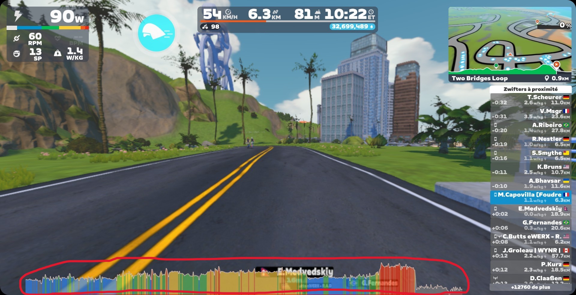

Since February 2024, I’ve been experiencing power transmission issues during free rides/events on Zwift. The power transmitted by the trainer is unstable (sudden variations of several dozen watts with a jerky pedaling sensation and an inability to maintain stable power, as if it were continuous slope changes: see spikes on attached graphs).

Yesterday, the power was completely aberrant at the end of a workout in ERG mode, with this sensation of jerky pedaling like constant changes in slope (see first graph).
I had prepared to run new tests today (with the old trainer and trying Zwift on another computer I’ve never used for this), but the game is working normally again without any special intervention (see second and third graphs)…

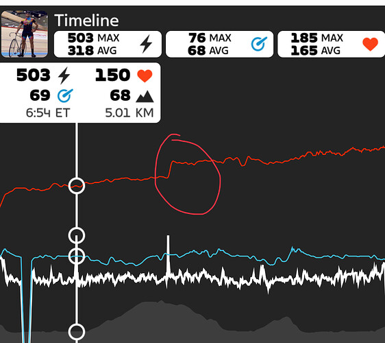

I never quite got hold of what it was, but it seems stable now.
What happened was that HR all of a sudden did a 20-40 bpm jump…and stayed there
Knowing I can’t sustain very long with a HR way above my max, it was easily identified as an error, but never quite found out what it was.
Only happened on that PC. Not on my ipad and not laptop
